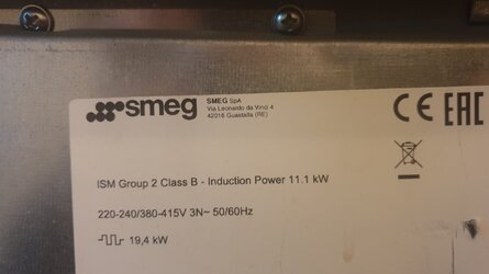

Hope someone could help, I have a Smeg induction range cooker that randomly trips the switch to all the plug sockets in the house but never trips the switch the cooker is on, we have had an electrician check the wire from the cooker to the mains and all came back OK and a specialist smeg repair man look at it and no one can find fault.
It will randomly trip doesn't matter whether its the oven being used or just the induction hob, it could trip 3 times per hour then go days without problem a
The model number is tr93ix si 08.

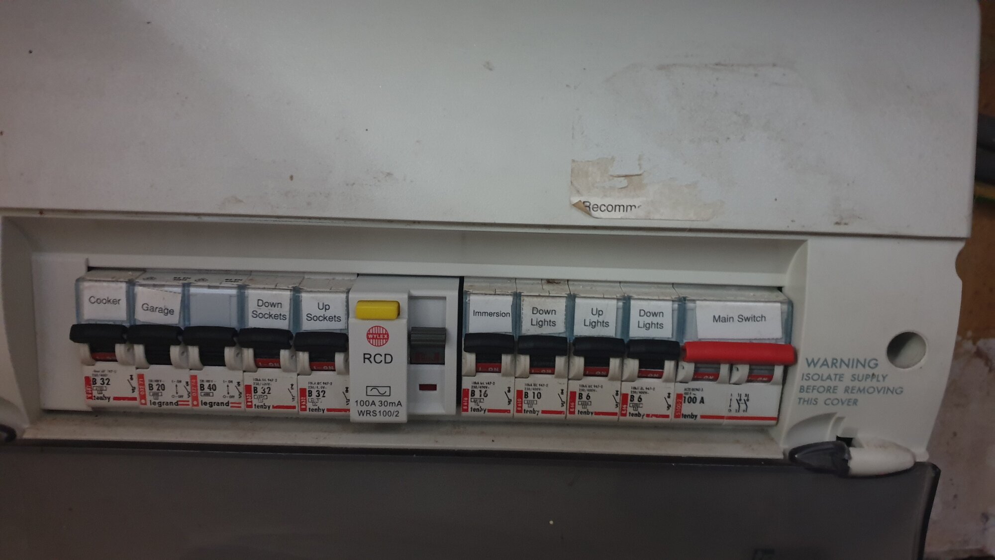

a Picture of the consumer unit (fuse board etc) would help us here.

I'm assuming it's the RCD switch in the middle that is tripping.
It would be an interesting experiment, though no doubt inconvenient, to turn off the MCB's for the garage, upstairs and downstairs sockets, and the unlabelled one in between, to see if the cooker still trips it!

Yes its the RCD that trips, I've already tried with them all off and still tripped.
The unlabelled one is the cooker, the one saying cooker is to an outside socket

So when everything else on the RCD side is switched off at their MCB's, but the cooker MCB is on, the RCD still trips.
Taken at face value, that implies the problem is with the cooker.
One final test might be to repeat that experiment with the cooker isolator in the kitchen switched off (to check the tripping stops) though you say an electrician has already checked the cooker circuit.
The reason I asked if the cooker was new, is that sometimes if a new oven has been stored in a warehouse for a while, the heating element can absorb a little moisture and develop a leakage current that can trip an RCD. After it dries out the problem goes away. Probably not the issue here if you've already used the oven a bit.
Does the cooker ever trip the RCD when you are not using it at all, ie nothing working on either the hob or the oven?

Yes thats correct everything else off and it still tripped, the cooker isolator switch was switched off each night so the electricity would still be on over night.
The problems started about a week after the warranty ran out so Smeg wouldn't look at it ?
Yes the cooker has tripped when not in use but isolator on

Coming from a French background i wonder if any of the experts in here (since i'm not one) think it's a reasonable suggestion that the AC RCD could be the problem? I've had a look at the cooker there doesn't seem to be much electronics on it so maybe this suggestion is bunk but i just noticed the AC RCD and it sprung to mind.
