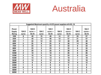

I discovered MeanWell have published their suggested number of power supplies/lights that can be fed with and without their current limiting unit ICL-16. It looks like their unit should do the job. If it were me, I'd give it a try!

That device is exactly what I am after - if it limits the current appropriately.
From what I read, it limits inrush current to 16A - which is more than 6, but perhaps short enough duration to make a difference.
Perhaps that and a 10A breaker, might be enough to make it over the line.

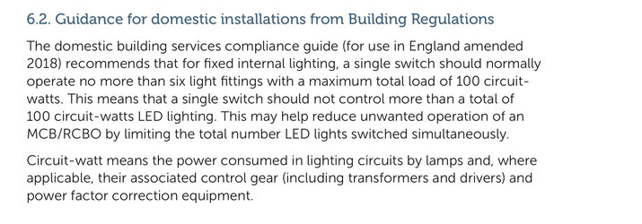

You can't just swap in a C type MCB or even a higher rated one.
You need to confirm that it is safe to do this, including checking that the earth fault loop impedance is low enough to be safe with a different MCB.
If the switches are not suitably rated for these changes they may also need to be replaced.
I suspect that this line from your opening post:
I have installed 12 40W batten lights (cheap Amazon variety - don’t have specs)
Is at the root of your problems.
