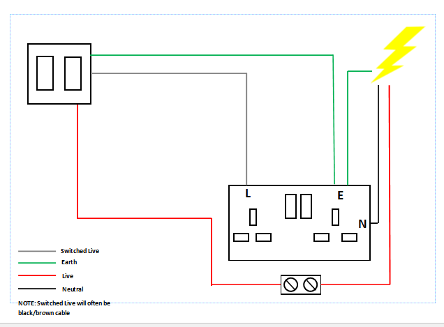

I am currently getting a kitchen overhaul and want to install some unit/kick-board lights. I want to be able to control the unit lights with the light-switch which controls the down-lights in the kitchen ceiling. I have swapped the switch out for a double switch.
The lights have came for the units but they require a plug socket. Currently i have created a double plug socket with a plastic external backbox which i have wired slightly different. I have attached a diagram of how this is currently wired up. The source of electricity (yellow spark in the diagram) is basically just an added spur from an existing socket. I have then decided to wire the live wire directly to the light-switch and a 'switched live' coming from the light switch going back to the 'L' part of the plug socket. Hopefully the diagram will better explain this.
My questions are, is this safe to do so, or is there an easier way to accomplish what i am trying to do? As i know you should never create a plug socket spur from a lighting circuit as they are rated differently. So am i creating any potential risk by adding the 2 circuits in a single back-box for the light-switch even though they don't actually come into contact with eachother as they will be wired to different individual switches on the same faceplate. Also, what is the situation with the earth cables for this setup? The backbox is a plastic dry-wall one so there is no earthing to be done for the back box. So would i combine the 2 earth cables into the same earth-lug on the metal faceplate of the lightswitch?

Callum, I wont tell you to get an Electrician in, that idea is to put it bluntly, is a stupid idea, unsafe, dangerous.
I think what the instructions mean is, you can plug these lights into a 13 Amp socket, and not as you intended, to use the socket as a glorified junction box

To answer your question as to why I thinks it's a dangerous idea, you intend to supply the socket with a N and E and take the L to the switch, which undoubtedly already have a live present, so, hypothetically you could have a fault, or some work don on the lighting circuit, and the Electrician you would have engage to do the work on the lighting circuit, would of, I hope isolated the lighting circuit, only it wouldn't be dead as you would have, added another L to the switch position, yes he will have checked only to be faced with a DIY debacle.
So if you are intent on installing these lights, I would get a Kitchen fitter in to do the job cheaper than the Electrician you should have engaged to do the job in the first place.

I do not understand your response, the socket is wired correctly from a 30 Amp ring main, only difference is the live is going to a switch so that the live can be switched on and off. The socket would work fine if the live was wired directly to the 'L' port rather than the switch. SO what is the issue?
Tbh callum, its a better job than some who i know would do. I’ve some drill a hole through worktop and plug the lights into a socket and use that as there switching

I understand your logic completely, however, my consumer unit is an old-style one which does not allow seperate circuits to be switched off individually. I have attached a photo below, Therefore the entire electrics in the home will need to be switched off before any work is undertaken. Preventing your scenario.

Have you fused this down to 3 or 5A? Also what type of cable have you used, and how have you installed it?
In theory this works, what kind of cable have you used?

I have given you my reasons, if you won't or can't accept them, I am not going to take any further part of this thread, it's not my policy to walk DIYers through a comprehensive install, which could cause injury to you or your family.
