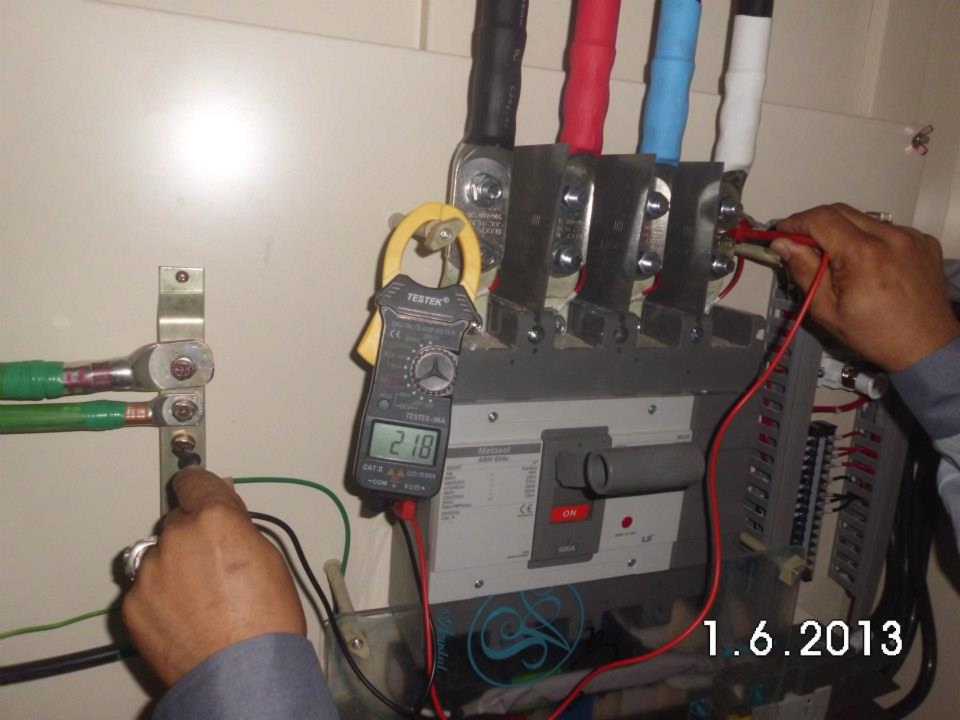

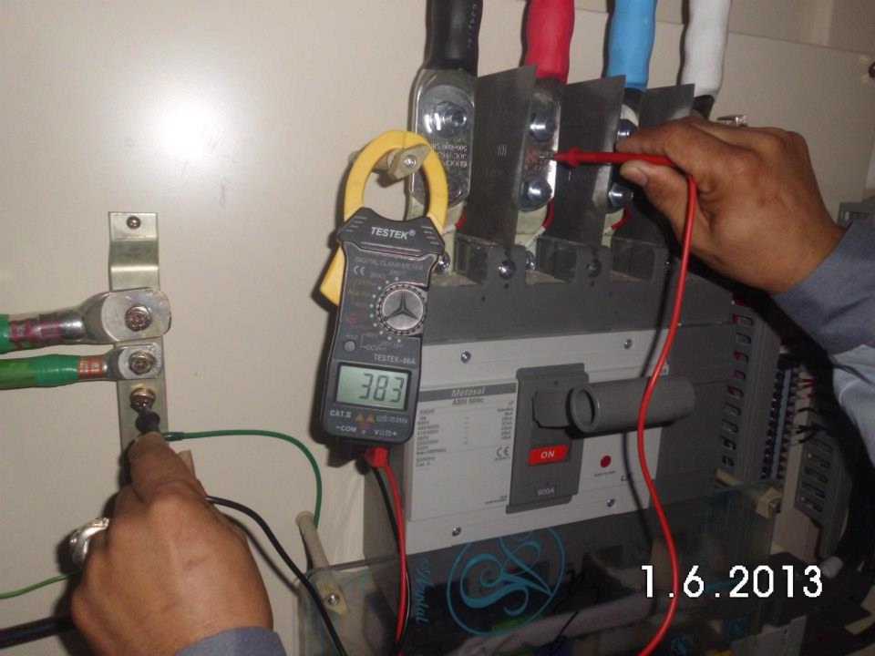

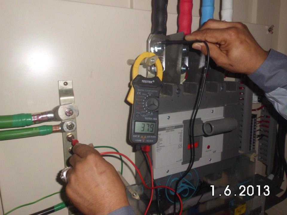

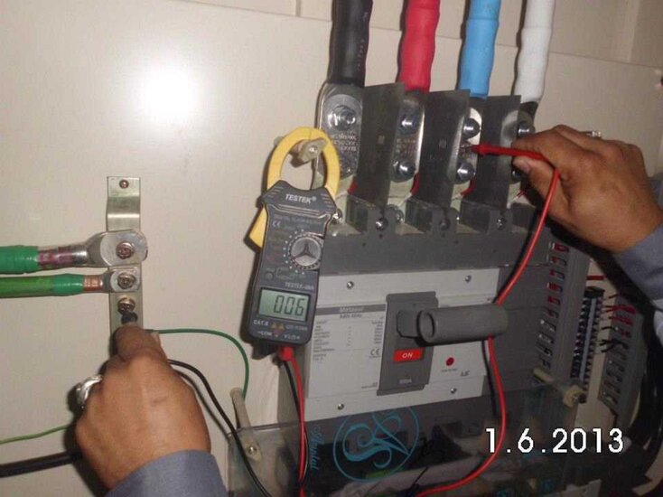

I will refer a weird voltage readings on my mate's workplace.. A newly installed transformer delta-wye, 440/380V will supply a TT power system. He measured 380V per phase on the secondary and 220V L-N.. But when he measured L3 to earth he measured 0V. L1 and L2 to earth is 380V and Neutral to earth is 220V.. I said that cant be and obviously L3 was mistakenly wired as neutral and earthed and the real neutral was put to L3. But he was sure that it is 380V per phase and the korean who installed the tx dont know whats causing the phenomenon hehe.. Is there anyone who have experienced this? I never really saw the installation but its really confusing if its really true.. Thanks in advance.

As per him, white cable is the neutral..and solidly earthed.. L-L voltage is 380V,but L and N to earth are the only evidence he has.. How come that voltage to earth is 380V? and L3 to earth is zero? when he said that neutral is solidly earthed and measured L-L voltage is 380V...
Confusing!

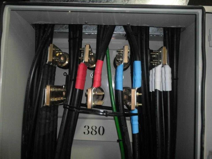

Is it possible that the blue wire will induce current to earth cable..And explains the voltage measurements?
I wonder how long it's going to be, before those cable ties stretch and those cables are going to embed themselves on those ultra long connection bolts?? Expect a big bang in the not too distant future!! Something doesn't look quite right with the cable connections to these bushing studs either, the directions just don't tally up. Are their loops in some of these parallel cables that we can't see??
Anyway, this isn't an installation that i would accept!!
Reactions: 1 person
