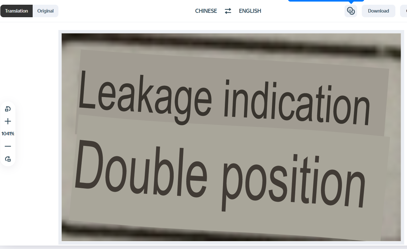

So does it indicate whether it's a RCD trip or a MCB trip? Could do with incorporating into UK RCBOs if it does.
Ooh interesting! Maybe that's it!
The lever on the MCB bit moves the internals... It's possible that an over-current moves the internals in a way that will pop out the button via the side lever (as well as tripping the front lever down).
Thinking about it, it must be the other way round.
The RCD bit, when triggered by a fault, moves the little lever on the side of the RCD bit, which then pushes the internals of the MCB bit, which disconnects the line (L). I suspect at this point, the little red button pops out.
So you'll need to push the button back in, before you can reset the MCB.
Now the little diagram on the front makes sense, too!
But it does tell you whether it's the RCD that has tripped, or an over-current.
Huh!
So I guess it's a single pole device (like most single module "full height" RCBOs), just made in a modular way.
