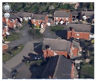

Any chance of some pictures? (maybe screenshot captures from google maps)
The shading might not be as bad as you fear and there are lots of clever tricks which could be used to get the best from the panels even if they suffer hard shadow at certain times of day.

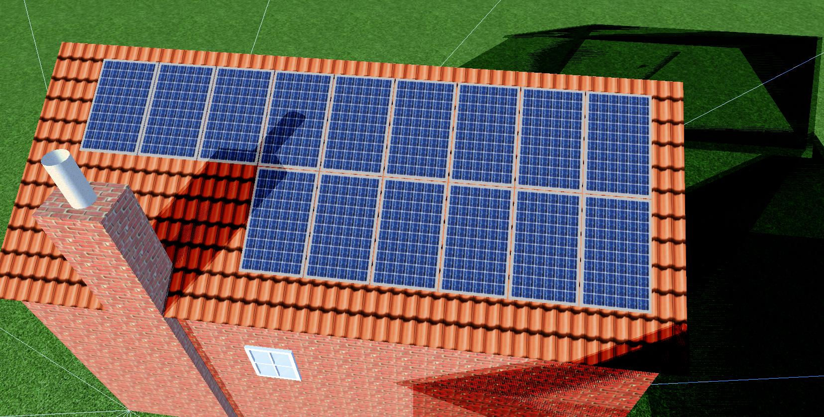

Okay, below are a couple of screenshots of our PV*Sol model for this project.
The roof faces just 10degrees off south and the two shading issues come from the chimney and the neighbouring property to the south.
I've placed some REC 260w panels in this design and laid them in the least shaded areas.
Screenshot_Screenshot3.jpg The chimney clearly gives the most shading but with the panels in this layout, most of the shading is cast on the lower row of panels.
Screenshot_Screenshot4.jpg This screenshot shows the shade cast on 13th October at 3pm.
I've tried a few different string configurations and I get a yield of 3,542kWh on a Power One 3.6. With a Solar Edge system, I get a yield of 3,627kWh.
The yield loss due to shading on the Power One option comes in at 6.9% and at 6% on the SolarEdge system. The extra yield on the Solar Edge system probably comes from the increased yield as mismatch penalties don't apply.
I would think that it would be a judgement call. Personally I am not a big fan of having too much electronic equipment on a roof and I would argue it should be avoided if possible. In this instance I would say that the shading cast on the roof doesn't warrant a SE system.

Thanks for your help. I have attached a picture of our house from Google Earth. It is the house with the word 'Peveril' running across the front of it. Looking at the picture I have noticed some other shading as well, presumably from the house in front.

Is it viable to have all the panels arranged in landscape as close to the ridge and/or as far to the right as possible? I reckon the roof is wide enough to take rows of six along the ridge and at least four per row on the unshaded right. The sun would have to be very low in the sky to affect those on the ridgeline.
Can only get 5 in a row in landscape and the layout receives more shading this way.
I'd stick with that layout then.
I would worry about an "upper" and a "lower" string because in autumn, winter and spring that chimney is going to play games with the leftmost five panels on the upper row.
If we number the panels 1-15, starting at the top left as #1, the top right as #9 and with #10 being the one on the bottom row closest the chimney, I think I'd have the eight on the right (6,7,8,9,12,13,14,15) on one MPPT and the seven on the left (1,2,3,4,5,11,12) on another.
I appreciate that #5 has less impairment than #12 and you might want the least-impaired panels on one string, but I think in the afternoons #5 will be more affected than #12 as the sun shines between the chimney and the neighbour's roof (your first image shows what I mean).
The second string is going to be a bit of a mess and rarely reach its full potential, but a scan function for optimum voltage should be able to keep it running close to three-quarters potential on sunny days (and no noticeable losses on the many cloudy days).
Actually, I think you'd be surprised. Which is why PV Sol is such an excellent piece of software.
You can try different string set ups and it will recommend a best option. No guess work. I've been trying to post a video to show you what I mean.
As I said before - Power-One probably split into 8 and 7, set the full MPPT scan function to 5 minutes, and maybe adjust the low voltage setting down to allow for lower string voltages on the shaded side when shading has knocked out a few of the strings within the panels.
string systems underperform badly in shaded conditions when the installer doesn't know what they're doing, and either spec an unsuitable inverter, or don't set it up properly.
As your numbers indicate, solar edge would likely outperform the power-one, but not really by enough to justify the extra expense in this situation IMO.
