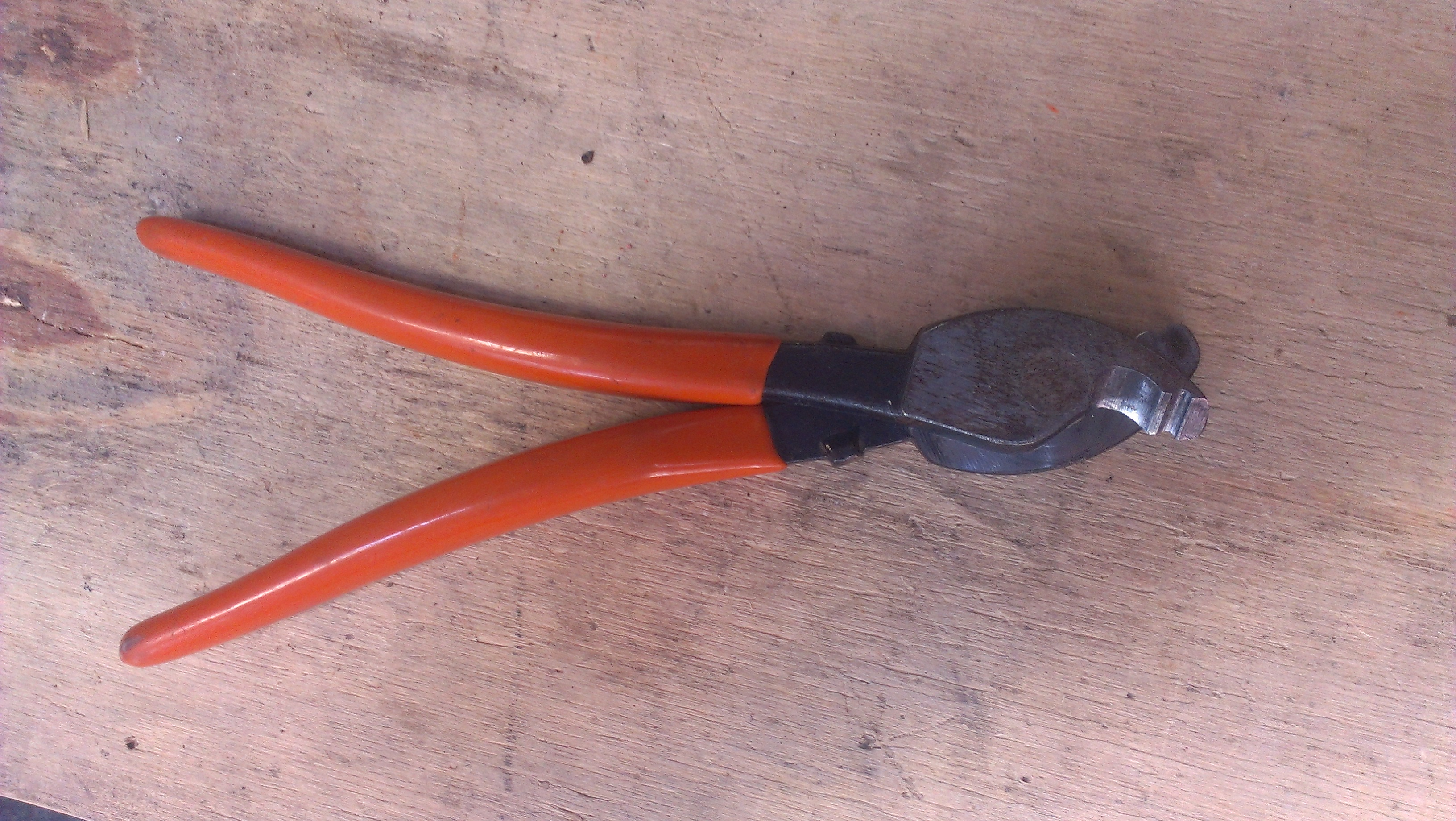

They will breeze through up to 25mm. I have had the yellow and red handle ones 10 years but cant seem to find them

I have CK and Knipex , both cut effortlessly

I had an old pair of orbis will (knipex) cable shears which previously belonged to my dad.
They were pretty good and chomping heavy gauge cable.
But over time got blunter and blunter.
I now use a ratchet cutter which is very good and ripping through tails and small armoured cables
I use simple Bahco croppers. Sharp as a gin and tonic after years of use. I think the CK versions are supposed to be identical in style and quality. Probably same factory.

I can't find the CK exact ones , very similar to these .
As @Dobes_88 The knipex Installation pliers are very good too , but are only recommended up to 16 mm .
The CK of the link I have posted do two sizes , 16mm and 25mm.
