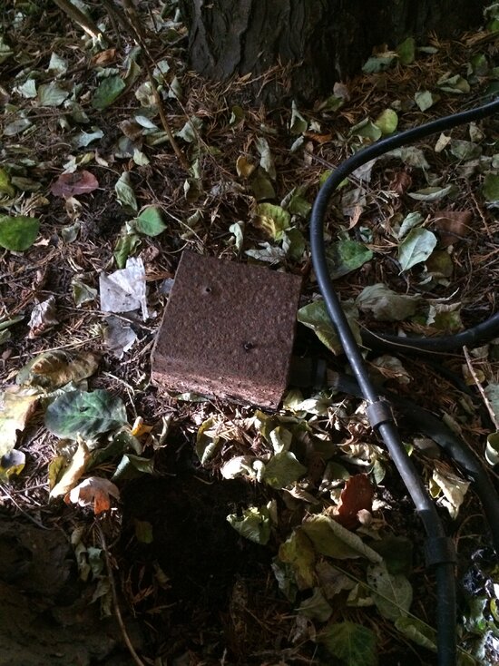

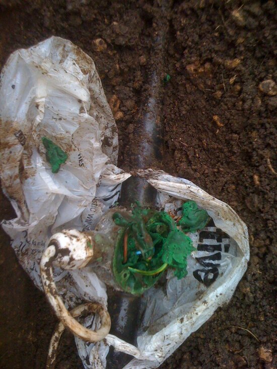

I would advise against burying connection boxes unless they are specifically designed for the task. Even an IP66 box filled with water repellent gel can be the culprit of a failed circuit in not too long at all.
Any cables you bury will need to satisfy the regs regarding buried cables as well. I would consider getting an electrician to design, install and test this project for you.
If I bury I use resin joints seen too many joints filled with silicone, gell or other gunge all will fail eventually and will be a pain to sort.
Ahuh. Last ones I saw were IP66 boxes with good quality compression glands, all nipped up tight and filled with "magic gel". IR readings were through the floor after 18 months of being installed.
Would definitely use steel boxes, at least that way the armour may get earthed. Keep them accessible with Wagos inside.
