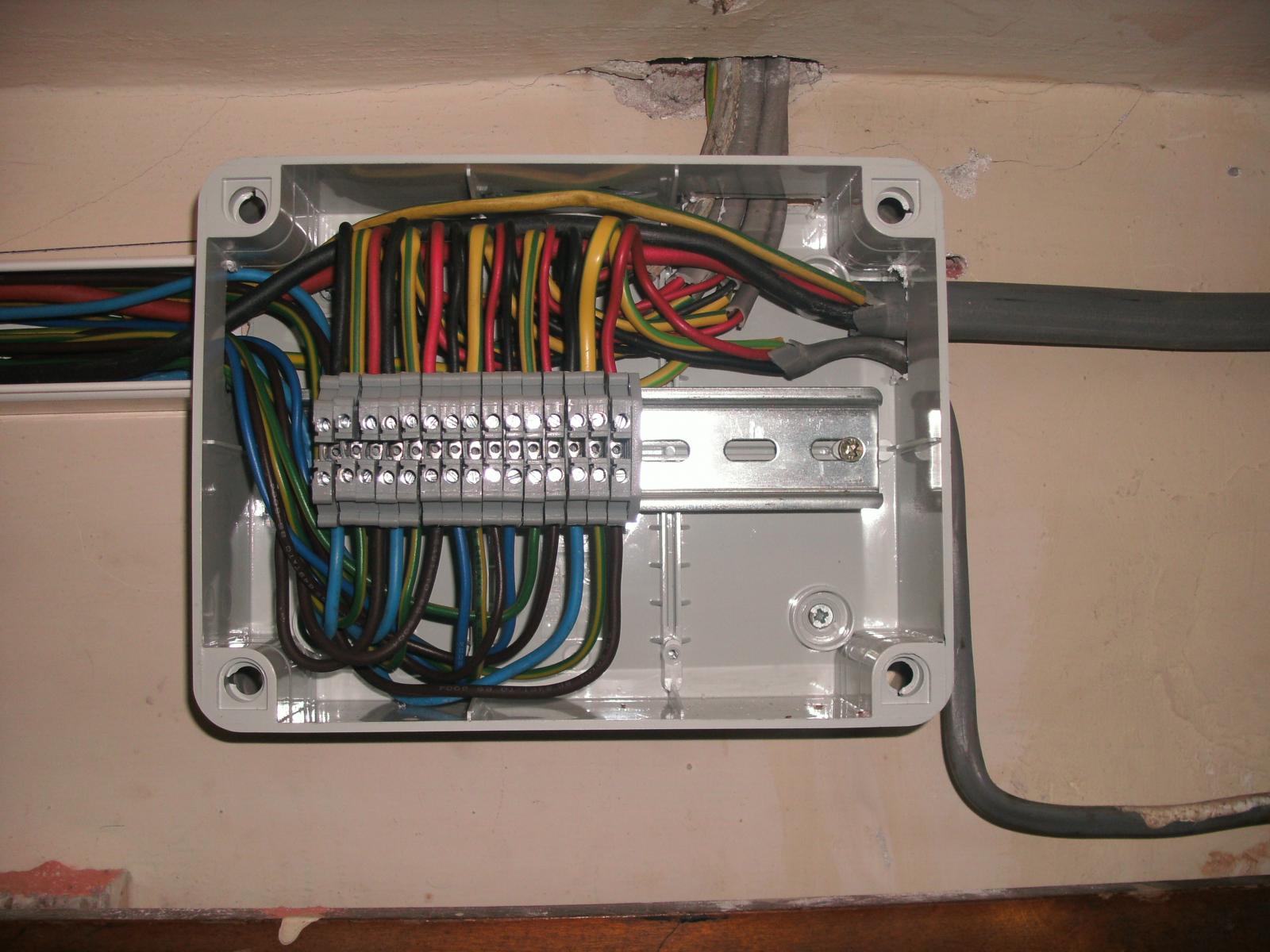

What make of din rail connectors are those? Just been onto the Line website and they seem to have stopped selling them. I need to buy quite a lot of them so looking for something which is good value!
they were screw ones from local wholesaler. wago do push-ins, and i'm sure line do them.
Line usually do them but they aren't coming up on their website any more. Will have a look for the wago ones. Don't want to use screw terminals, might as well use connector blocks! ;)
