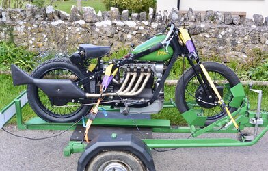

I ought to include a 'photo of me looking 30 years older due to the stress of the dynamo issue.
Nice. Suicide shifter looks well engineered. How much of the frame is original?
Upvote 0
The frame is completely original but not the girder forks. There's an article about the bike in this month's Classic Bike magazine if you should find yourself browsing in WH Smiths. The Nimbus models in the mid 1930's would have had foot clutch/hand change.
Upvote 0
Tank looks well between the frame. What engine is it?
Upvote 0
It's a Danish Nimbus. It's 80% Nimbus but I've added the supercharger and built it from bits to resemble a Brooklands racer that never existed. This is a fake 'photo of it in the paddock at Brooklands in the 1930's.
