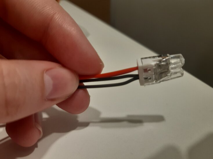

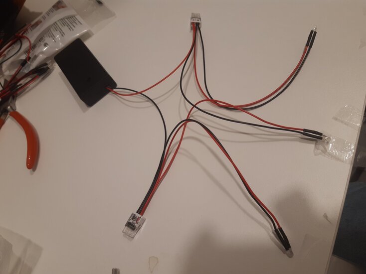

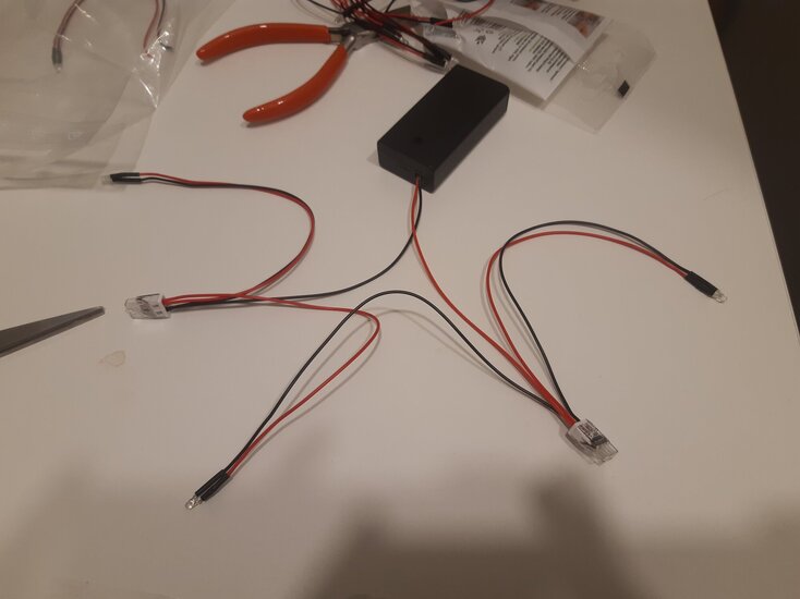

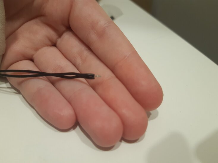

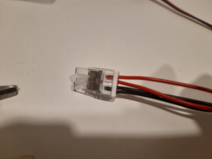

Sadly, something isn't working and the lights are not lighting up. I'm not sure if it's a voltage issue (im using two rechargeable AA batteries, 1.2V each, in a baterry pack, the lights were marketed as 3V-6V) or if I'm twisting the wires wrong. Thanks to anyone willing to share wisdom 💚

The LEDs appear wired incorrectly back to back - whereas you should wire the black from the first LED to the red of the second LED, etc. So they are all in series.
Reactions: DPG
Upvote 0
Agree with SJD. Also the 2.4V you have from the 2 cells may not be enough, but worth a try.
