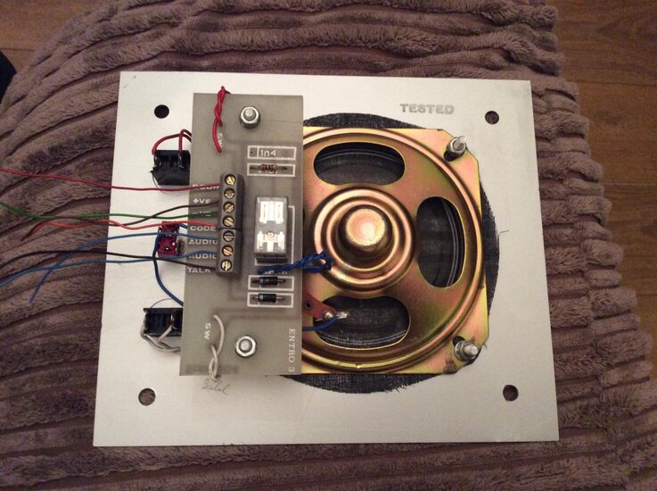

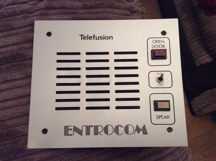

I'm wondering if anyone can help with out with a door entry phone handset that is compatible with a telefusion system?
I would like to replace the speaker/buzzer in a ground floor flat. I will include some pictures of the unit I would like to replace.
The external unit I didn't get a pic of but its just a normal looking but quite dated metal telefusion unit with about 20 different flats buttons on it.
Ive looked at a few handset comparability charts but none have got telefusion on them.
Any advice before I go and grab one I think might work would be much appreciated.

This is old unit, and nothing on the market today will be compatible. It uses the speaker as a mic when talk button is pressed, working in one way speech. The whole system would need replacing.
