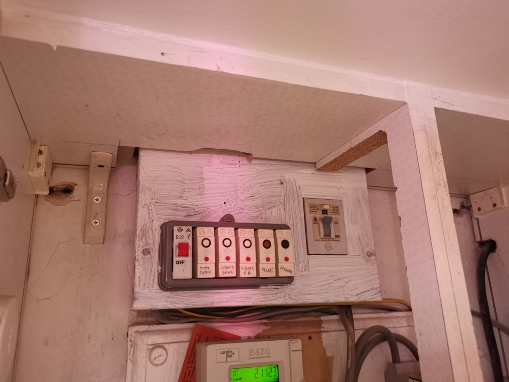

Can you show a pic of the consumer unit, just out of interest.

I didn't think they were supposed to be enclosed in wood either, but could be wrong?

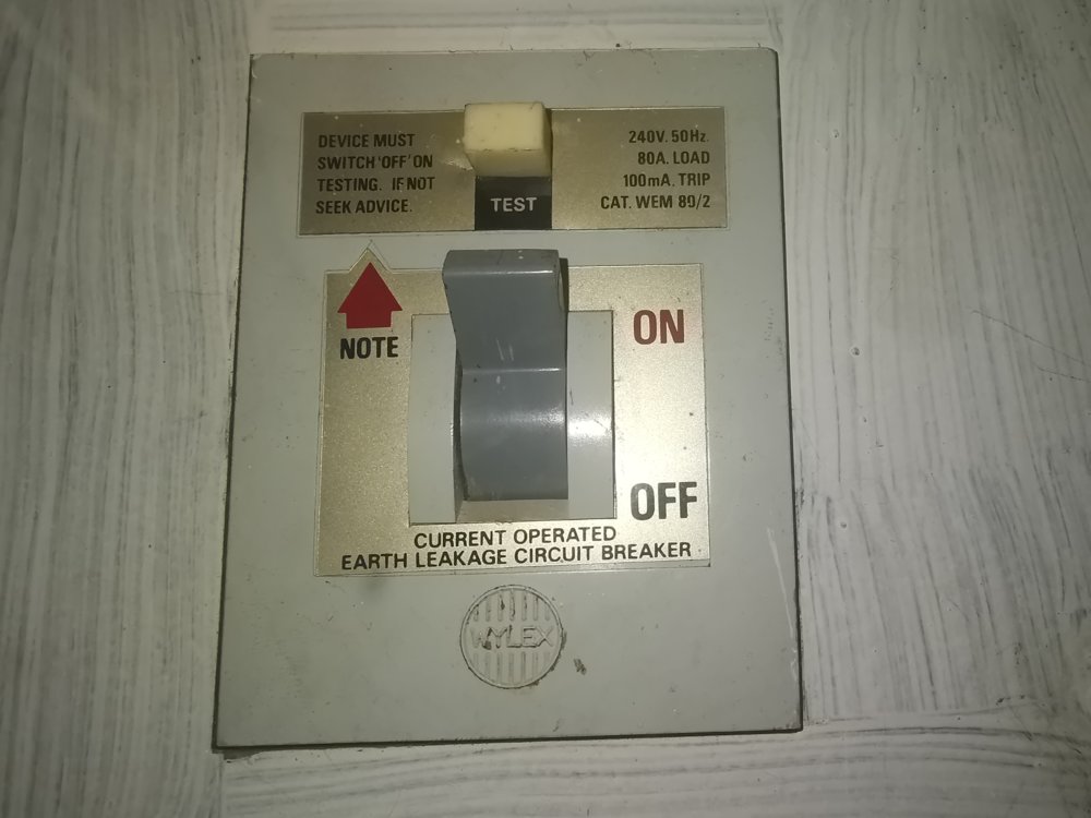

The main switch is an rcd hard to make out if it is 30ma but probably is. Press the test button see if it trips.
It's not encased in wood, it's a metal board. It's the plastic boards of that age which had a wooden backing plate.
Oh I meant the closure around the entire incoming supply, not the ccu.

It's 100ma and yes it does trip everything.

the outside sockets must be protected by a 30mA RCD. There’s a 100mA, so that’s downright dangerous and does not comply.

Are you sure it is 100ma and not 100A.

It is the Wylex WEM 80/2 100mA RCD (80A rated)
Thanks. As I said, that does not meet the (long required) need for outside sockets to be protected by a 30mA RCD. That should be provided on that garden SWA circuit too.
Whoever the muppet was that fitted the cupboard around the fuseboard did no think about the need to remove the front panel for maintenance!
A carpenter needs to remove sufficient wood to allow the front panel to be removed. No electrician will work on the installation without full access to the innerds!
Especially when/if landlord decides on an up to date consumer unit.
