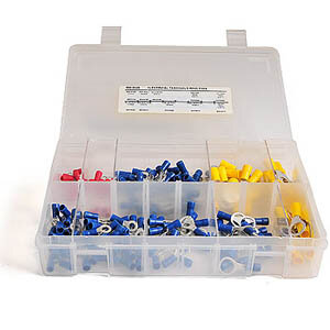

I have earthed the metallic sheath of SWA cable by wrapping around the bare earth wire (sleeved off) around a bolt and tightened on to the brass eyelet using a nut as shown in the picture.
Is this acceptable? or should I really crimp it using the one shown on the picture below and bolt it on to the brass eyelet?
Any feedback will be much appreciated.
Crimp it, the copper will squash over time and become loose, I also double nut it to make sure it stays tight.
And it looks crap! :D

Crimp it every time IMO have never be a big fan of copper wrapped around bolts.
Whats with the big nick in the cable bedding? hope it aint gone through any of the insulation!

As above always crimp. Also I always use brass bolt!
Can't say I'd use a gutter bolt either - Whats wrong with a proper brass pan screw? Also I agree with Truckster about using double nuts. Sorry mate but even for purely cosmetic reasons I would be happy with that.

Thanks for all the inputs, seemed like lesson time and I have learnt a few things. As Amp David says, I too love to use brass nuts/bolts but couldn’t find suitable ones and I am hence sticking to what I have used earlier. Really wanted to use “Piranha Earth Locking Nuts” but my local shop or the “Bigshed” doesn’t do them.
I have taken your advice on board and have crimped it with suitable eyelet. The IP rating of the box hasn’t been compromised as the hole I drilled was big enough just to thread the lug-nut thro’.

Yeah, they guys are right. Crimp, crimp and crimp. double nut and don't forget your washers and copper grease!
And be a little more careful with whatever you are striping the outer sheath of with. Looks like a stanley blade incident to me.
Just out of interest, did you split the cores on the earth cable? Seen this done countless times and given out many b*llockings for it.
