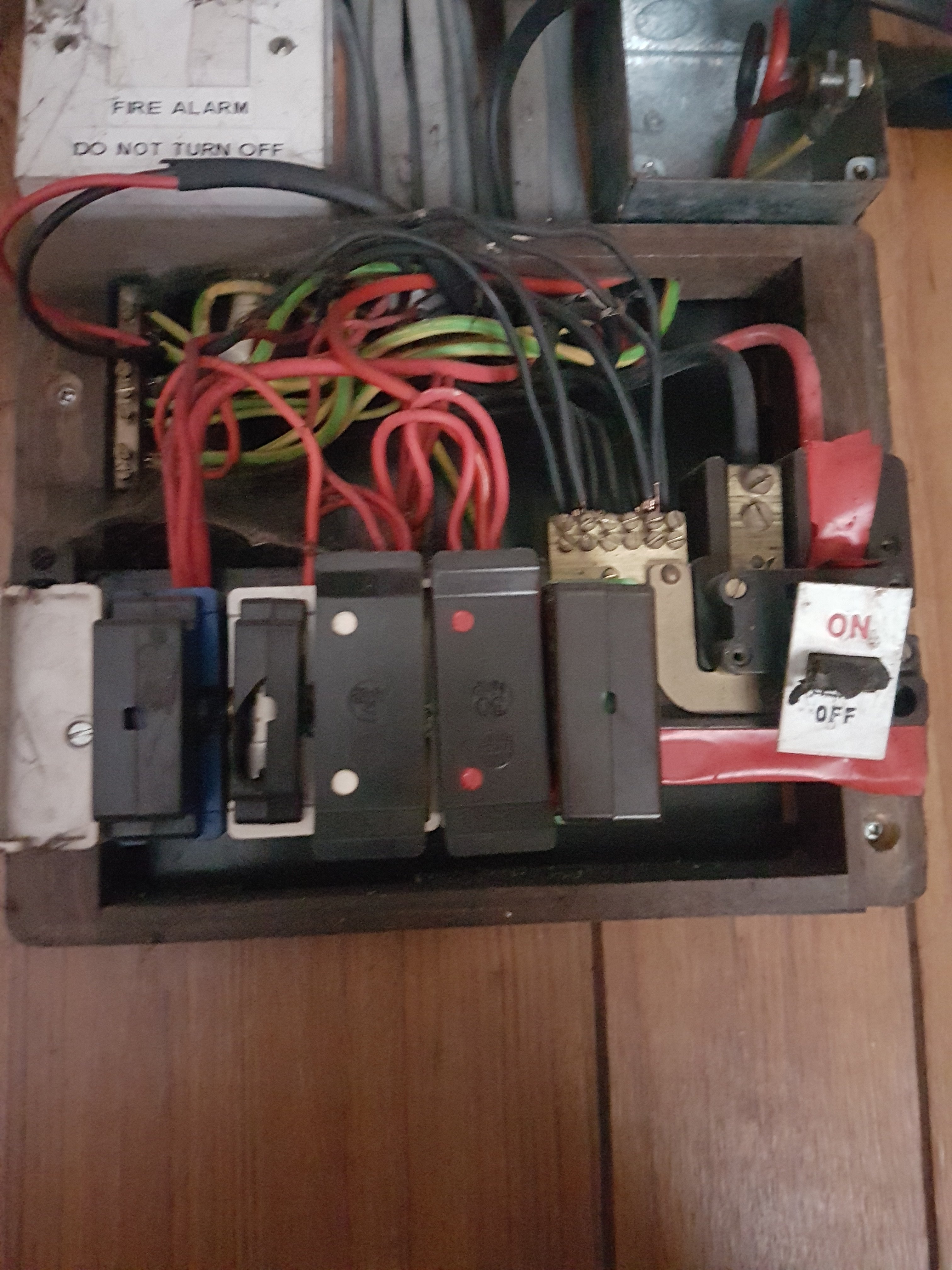

Was asked to an EICR a building today, old church converted into workshop. This was 1 of 6 boards, this is how i found it. Was told it hasn't had a cover in 20 years and the last electrician passed it so what's the issue? Some people are unbelievable. To make matters worse it's at head height and not even hard to reach

Needs sorting PDQ IMO
Isn't the FIRE ALARM DO NOT TURN OFF spur switched off:tearsofjoy:
The OLD colour code works ....RED for Danger ...
Those 3036 fuse carriers are upside down. You bin on the sauce Matthew.

gawd, it's been there 60 years and has not gone on fire. so much for metal CUs.
Reactions: DPG
Never actually seen an old Wylex catch fire.
All those spare ways, and it looks like several circuits are jammed in a single way.
Ask him to stick his fingers in there and see what happens, that’s what the issue is

A missing lid 40 years ago would still have been unacceptable...
In fact standards 30-40 years ago were very much better than they often are today
It’s only due to years of bad maintenance and diy interference most older installations get completely trashed

It is indeed there are fire alarm cables hanging everywhere I'm not even sure the alarm itself is there anymore. Red and black 2 core flex also has both cores connected to the earth bar whatever it is doing
How did you leave things, manage to make it safe?
Can you get hold of another cover?
Piece of cardboard with danger risk of electric shock scribbled on, hinged at top with bit of leccy tape (so you can lift up to rewire fuses) will do.

Why is there a blank on the left screwed to the wooden frame?
It's not on the frame it's the angle of the camera it's a 6 way board

there are 2 questions
"is it electrically unsafe?"
You've seen it so what would you say to the coroner?
