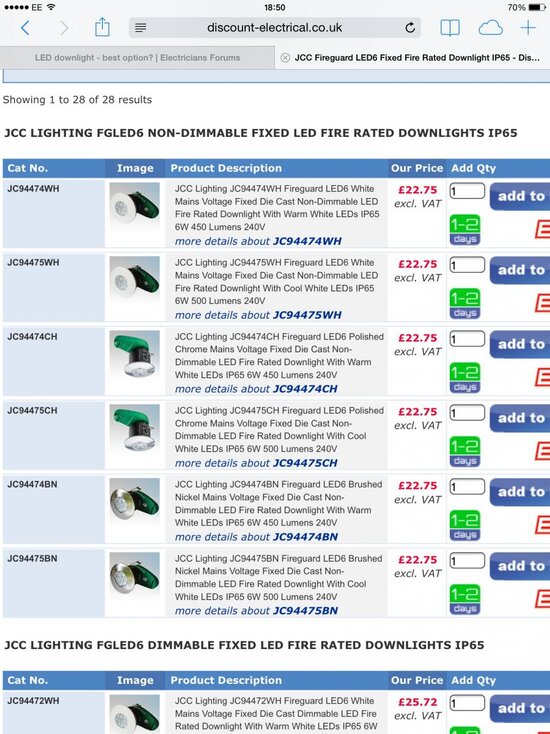

Got a few jobs coming up (mostly bathrooms) requiring LED downlights.
What are your preferences?
Ive mainly used GU10 cans with retrofit lamps mostly due to cost in the past but dedicated fittings seem to be getting more reasonable now.
I've used LEDhut lamps which were fine, Kosnic in my own house which are ok, aswell as a couple of NVC garland dedicated LED spots that seem really good.
Also installed 3 Ansell TITAN Led fittings in a customers kitchen, very high ceilings so opted for a high output fitting (850lumens), very bright, well put together and 7yr warranty but I've been back over the last 12 months and replaced each one!!
Just want a good fitting that I won't be called back to around £20-£25 inc vat. Any suggestions?
cheers
You won't go far wrong with JCC led 6 fittings , they are all IP66 rated fully sealed guaranteed and come in the 3 finishes and in cool, warm or daylight white ....
Cheers RG, seen them but they're right at the top of the price range along with the Halers H2s which I hear a lot about. Just a struggle to convince people they're worth the £30-£35 a fitting!!
Thats what Eddies do them near me and ask also if I have been quoted cheaper as well, I told them Denmans at £21 and they matched it ..

Just looking in Denmans connector , standard fitting = £21.95, Dimmable = £25.50, Tilt = £36.56, + vat , You can always order from them if theres not one nearby ...
