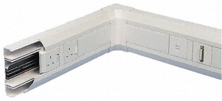

Would you be able to send me a link on the web so I can get an idea of this busbar with sockets? is it like the attached? As I said I have no practical experience with this area. which manufacturer of busbar is worth noting. we may have to get samples etc Going to larger cable will be fine 6 mm or busbar, in fact it defo going to have to be busbar as the shape of the strip suits a key design aspect we have to intergrate. adding another ring is simply not an option, due to this hidden feature which really complicates things, its got to be 150mtr loop no breaks, idealy one consumer unit.

VERY MORE HAZARDOUS, think you had better get a qualified Electrical Engineer to help with the design of this idea before someone get seriously hurt.
Here is a link for a PDF catalogue of the type of busbar systems I have come across in the past.
It is suspended from the ceiling and has tap off points at regular intervals for fused plug in modules.
Hope that helps
