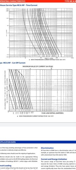

carrying out an eicr on a building recently we found the external ze reading to be extremely low ie 0.02ohms. so by measurement and testing are fault current read 20ka. now most of the mcbs rcbos ets have an icn of 10kohms. this poses a problem as obvisoluy the mcbs etc would self destruct under fault conditions. what would you code this and more importantly how would we rectify this problem, Interested to here your thoughts.

The reading may be perfectly correct, and the mcbs ok as well.
If the installation is protected by fuses, the let through may be less than the rating of the downstream mcbs.
Just check the fuse let through first.

all the mcbs are 10k icn would be extremely expensive to change them what code would you give to this
If the let through is greater than 10kA, its c2
If its less, then no code

Julie were would I find the let through value and are you talking about the main incomer fuses
Yes, so if they are say bs88 industrial fuses, anything below about 125A would be less than 10kA let through for 20kA perspective.
You need the manufacturer's data, there will be a curve showing this data, select 20kA on the prospective axis and follow it until it reaches the appropriate fuse line/curve then on the other axis you can read the actual let through current
Reactions: Farmelectrics
Here's an example if you select 20kA on the lhs and go across to the 100A fuse line, then follow it down - or up, it gives a let through of 9kAScreenshot_20201022-204047_Drive.jpg
ok I understand that thank you. so the breakers in the dbs that we have tested are all Schneider type, and there all 10ka breaking capacity and with a fault current of 20ka. so if I look into the let through value and that's above 10ka im happy to code 2 it. But if the client asks how we resolve it were do I go with it . thanks in advance

As Julie already mentioned, if there is the typical incomer BS88 fuse of 100A or so it is going to limit the PFC let-through to a value that will be safe. Remember, fuses are your friend!
