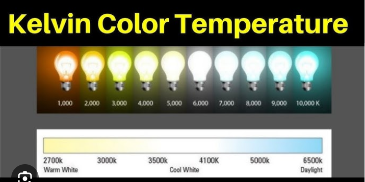

Assuming this is secondary lighting, I think they will be much too bright for the application what is the luminous output? (what colour are they (3000k, 4000k ??)

Thank goodness for that! 😄 They are secondary lighting and I hoped they wouldn’t be too bright 😩 They are 6500k cool white! 😣Maybe I’ll be glad of a voltage drop!
6500k is more 'Daylight' than Cool White and diffusers wont dampen it down much if clear or frosted.
Volt drop wont necessarily cause the whole strip to 'dim' as you would still have 12v near the source so full brightness and 9v (say) at farthest point so not full brightness more of a graduated dimming along the length!
Looks like I need to think again then. Maybe I should have gone for warm white instead 😔
