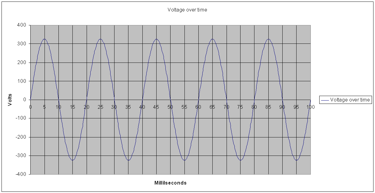

At 40ms trip time the voltage (and current) will have peaked four times, at 54ms there are another two chances to kill someone so a 50% increase. Not really ideal, even if in the real world the variability of conditions on the circuit, on the person and in the external influences would be such that you could never tell if someone would be killed by a particular current it would not be nice to think that you had not done all you are required to do as a minimum to save them.
Reactions: 2 people
