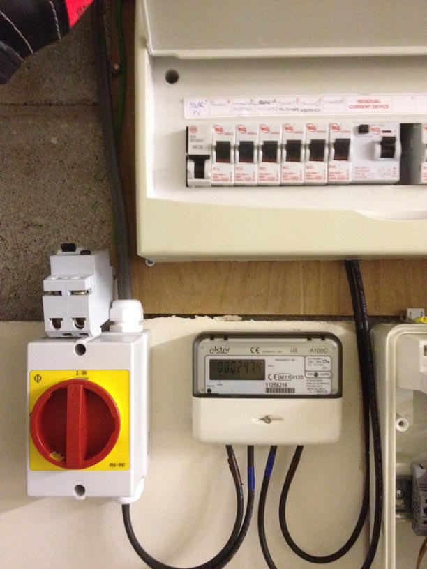

Here's the meter & RCD. PV fuse on left side of board if you can't read it. photo1.jpg
Looks to be fed from the main CU via shared RCD. What type of cable is that used between the CU and the meter / AC isolator?
The cable looks like standard PV cable to me. I wonder if the AC isolator has a CPC to it?
The issue with the PV being fed from the shared isn't just nuisance tripping. It will also affect disconnection times.
If there is a fault of one of the circuits which are protected by the RCD, say for example the sockets, then the RCD will operate yet the PV system will still be feeding power to the circuit.

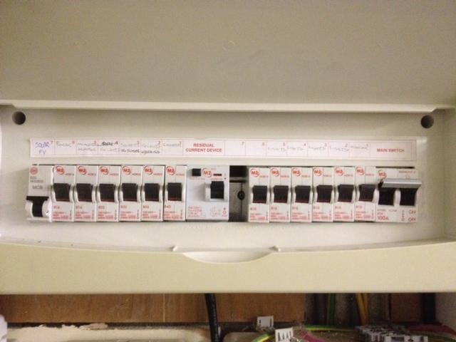

Does your current comsumer unit have two RCD units? Or just the one?
If it is just the one, and the method of installation allows it, the installer could simply move the circuit to the other side of the board - looking at your picture, there appears to be a spare way.
Just a thought on the cable that was used, it is possible that it will have a high voltage drop, which is making your system go overvoltage, and tripping the RCD which sounds like it is wired up wrong anyway.
The cable from the inverter (in the loft) down to the export meter in the photo, or the cable from the meter into the consumer unit?

As others have said, the problem is that it is sharing the rcd.
I could not see anything specific in terms of recommendations for rcds in the instructions, but it is galvanically isolated and should be able to take being on a standard 30mA rcd.
Opinions differ a bit, but normally I would not use an rcd for an inverter unless there was a specific reason to do so. Some installers are in the rcd everything brigade.
You probably have small leakage currents in your existing circuits on the rcd, either from the cables or from an appliance. That by itself is not enough to trip the rcd. Nor is the solar pv on its own enough to trip the rcd. However when the leakages are combined they do trip. A 30mA rcd is within spec provided it trips above 15mA and by 30mA (in simple terms).
The answer as others have indicated will be to separate the circuits so the solar pv is not sharing an rcd with others.

The simple way is just to move the solar pv breaker to the non-rcd side of the board (assuming cable is not buried <50mm in a wall)
Ask your installer if it is possible to move the circuit to the non-RCD protected side of the board. It may be the case that the way he has wired the installation means that it requires RCD protection - if not, then this is a very simple solution.

That can be a complex answer, but looking at the photos you have provided so far then in your case I suggest only if the cable from the inverter to the consumer unit is buried less than 50mm deep in a wall rather than being surface run or in trunking.
