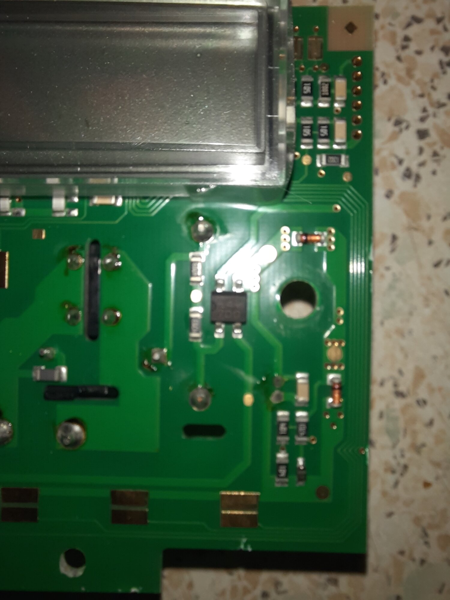

Following MJ’s theme - MOVs do degrade each time they react to over voltages. It is not unknown for them to eventually suffer thermal runaway which is when their quiescent current rises over time, the MOV warms up, its resistance reduces, it passes more current, it warms up even more…until it cannot dissipate the heat quickly enough to its surroundings and it destructs. All of which can happen in the absence of any overvoltage.

@marconi I'll let you off if you can find a SIL through-hole bridge rec in a white package made in the last 25 years.?
We can now confirm from the PCB pics that the failed part is across the mains input. In theory it could have been a small filter capacitor but:
a) The part shape and burst pattern are more consistent with an MOV
b) A cap of those dimensions would typically be a Y-class part of a few nF which is not appropriate there.
c) An MOV is not a bad idea where a capacitive dropper is tapped off the supply to a relay-switched 16A load of unspecified characteristics.
What it will hopefully have been doing, before it popped, was shaving off transients likely to damage the dielectric of the X2 dropper cap, that would otherwise cause a progressive loss of capacitance to the self-healing process.

It stinks of a neutral connection. It's the only common denominator. I can't see 11 Sangamo clocks packing up at the same time (Greenbrook, maybe..)

The TT or TN supply type won't make any difference to equipment damage if you have an neutral fault on a 3-phase group of circuits. What is more likely to make a difference to the stats is the types of cable/joints used that might alter just how common such a fault is.

Anyway had a chat with the contact at the flats this morning and to be honest I'm befuddled by her explanation.
They have had the situation looked at and resolved. Apparently it was "some flat plugging in too many appliances and burnt out a fuse and some wires"
I find this highly implausible.
Any overload should have been dealt with by the OCPDs in the flats and not downstream. Unless the design of the installation was seriously FUBAR.
More likely they got the installers back in to check it over and they've tightened up their loose neutrals.
