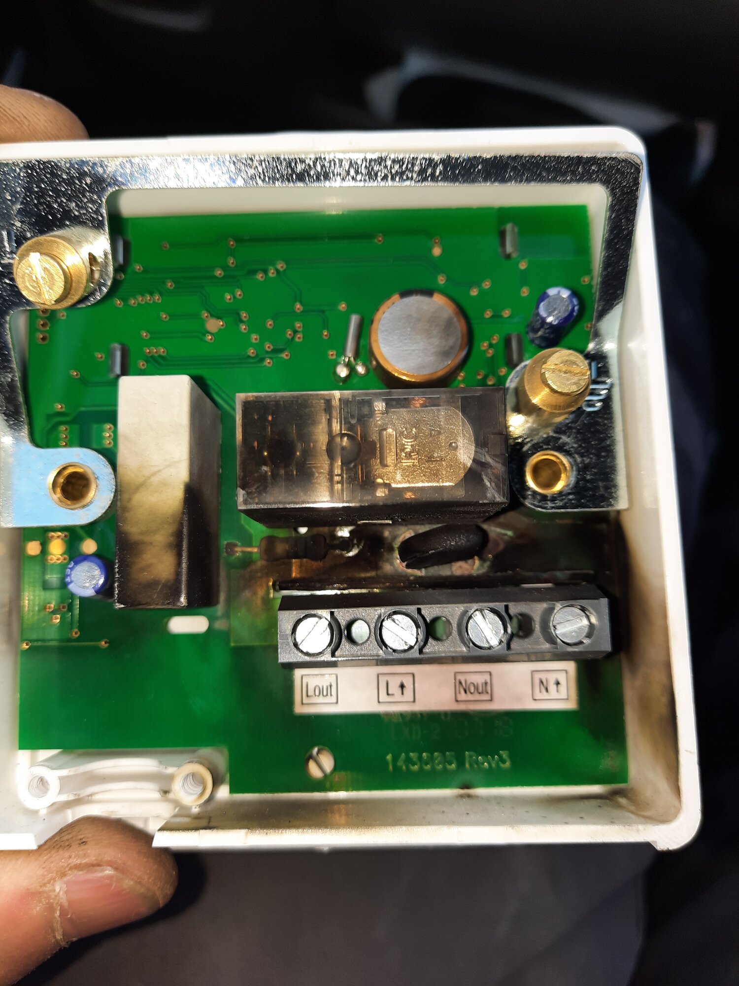

Here's some photos @Lucien Nunes and others.
The terminals and cables are clean as a whistle.
This is the culprit
Capacitor(?) has blown.
Reactions: Jim_e_Jib

Looks like a metal oxide varistor connected across the supply, If several blew at once this is a sure sign of overvoltage on the supply. A MOV is normally high resistance, but it's resistance drops as the voltage increases to stop voltage spikes. A sustained overvoltage such as from a supply fault will quickly overheat and destroy an MOV.

Yup, it sure does look like an MOV that wasn't big enough absorb the available energy in the overvoltage event. When that happens, it can initiate an arc that lasts until the fuse blows, which can dissipate so much more energy that it makes it hard to identify whether the trigger event was an impulse or a prolonged excursion above clamping voltage.
Assuming the building is served by conventional urban underground distribution the latter seems the most likely and I would say the likelihood of a cable fault causing both the timer damage and the flickering / outage events was very high. Other items in the properies with MOVs (and even SPDs) might also have been compromised, but if the MOVs in the timers had a slightly lower clamping voltage then they might have all gone phut before many of the remainder showed signs of distress.

The catastrophic failure or the MOV (thanks) in the controller would point to a large over voltage situation.
It is most probably not environmental but a lost Neutral.

I don’t think the burned out disc is an MOV. The timer uses a transformer less way of producing low voltage dc to operate the electronics. I reckon one can see a bridge rectifier - the white block component, and a disc capacitor in series with a resistor of suitable power rating together forming a mains to low voltage dropper. The placement of the resistor and the disc capacitor makes me think their right hand ends are connected to Lin and Nin respectively and their left hand ends to the ac inputs of the bridge rectifier which are normally the inner two leads for this style of rectifier. There is a smoothing capacitor to the left of the bridge rectifier. I reckon the gold rimmed cylindrical component above the relay is a battery for keep alive in the event of power cut and accumulator to handle short duration current surges when the relay turns on.

A picture of the underside of the PCB would be handy.
Reactions: freddo
The white block will be the dropper capacitor, the bridge rec will be SMD. But yes, let's see some pics of the PCB
I was wrong ?

Block of 200+ flats, eleven single channel hot water timers blown this week alone.
