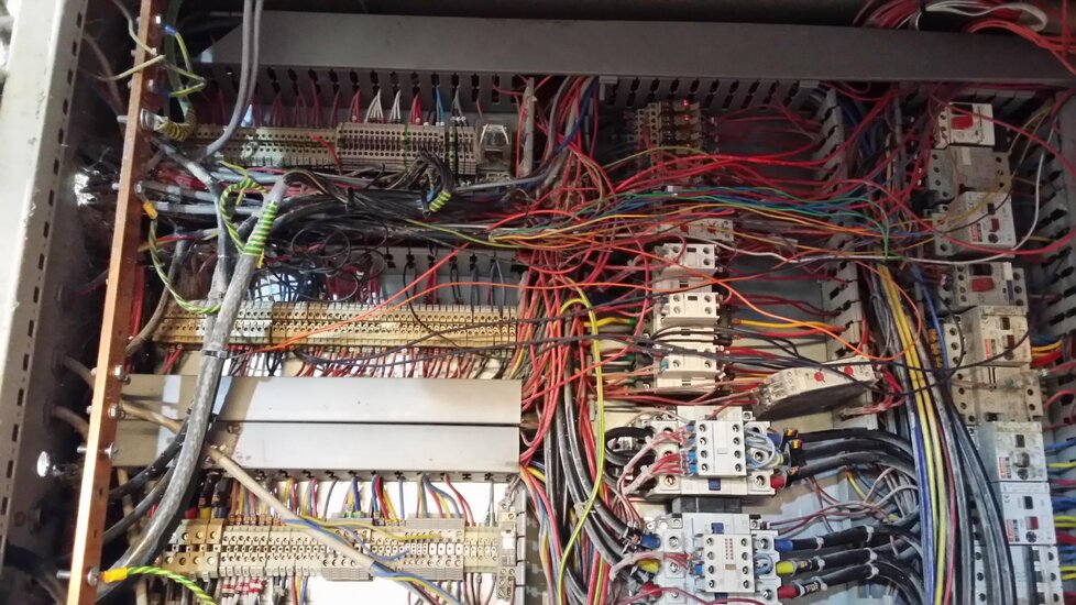

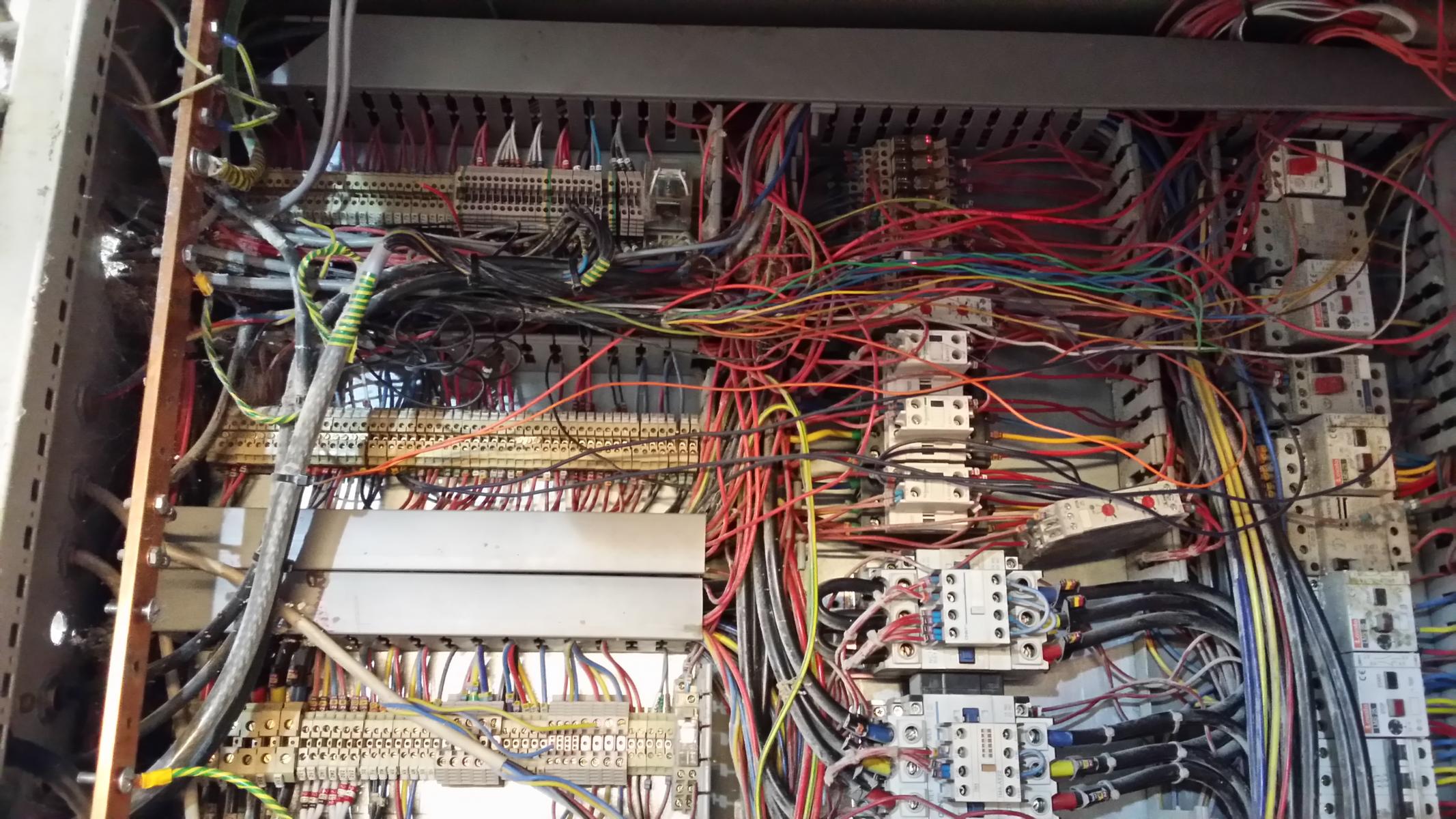

Got asked if I could just tidy up a customers panel up a bit, he said his previous guy used to be able to get the Machine running all the time but wasn't the tidiest of guys.
within 2 minutes of looking at this mess I had cost the customer quite a lot of money.

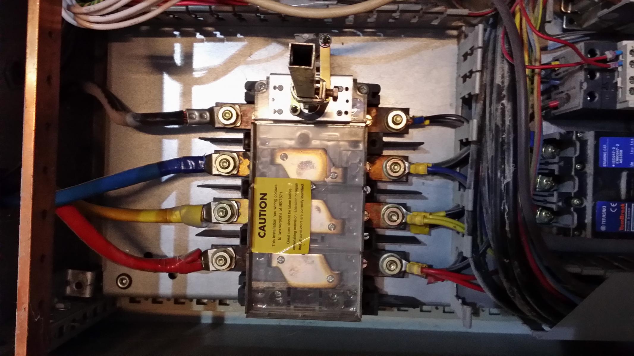

The isolator you see does not work, so the isolator get switched on with a spanner or grips then the door is closed
All the terminals are exposed to touch, due to above line, so obviously can't be isolated before opening the door
terminal covers missing anyway as you can see
wires just thrown from one contactor to another, without taking it through the trunking
Loads of Ip issues due to holes all over the panel
Plus many many more issues

...They are clean,not bulging,and mainly functioning....looks like nice work,to me. Maybe you are feeling embarrassed about the hideous impending invoice due :coolgleamA: ...seriously,the German stuff i have worked on was superior to others,quality components and straight-forward nomenclature,Gottwald and Liebherr gear being top-drawer. Also,on second-hand equipment,panels sometimes come with neatly fitted and wired timers,transformers etc,which match others in panel,but were for completely different machines,not associated with the newly arrived plant... It's just like finding your way round Uzbekistan using a Uzbekistani A to Z,if you have drawings...if not,it's pac-man down every road! Happy billing fella :stooge_curly:
Sorry mate I would of liked to of been neater but you know what it's like, they lost the drawings, everytime I got near the thing it was on callout at stupid o'clock in the morning so I just wanted to get done and go home and after a while I just stopped caring knowing fine well I'd made a fortune roughing it in and some other mug would come along and tidy it up sooner or later
Seriously though, don't you just love machine panels they are always a mix and match rats nest that very rarely have drawings that make any sense, looks like your going to be a busy chimp if they are wanting them all redone, tidied up and fully documented, on the bright side though you'll be minted off the back of this customer

Just think, that was once brand new, with all the lidding on, everything on the din rail and all the MPCBs the same breed, shiny and new.........and then the maintenance brigade got to it.

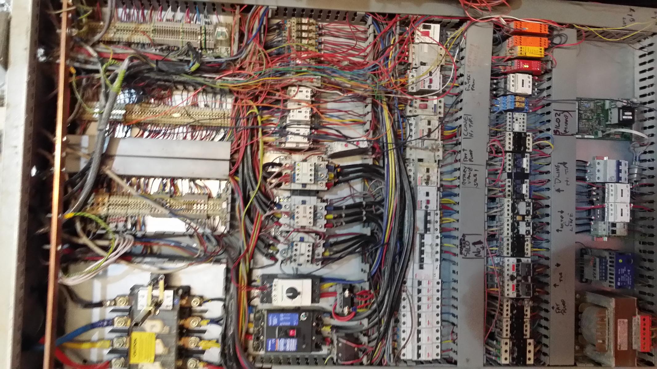

With some of the German panels I've worked on you have to have drawings as they don't use cable markers. Changing a safety relay with 20 brown wires on it becomes a challenge, I got into the habit of slipping on markers as I disconnected each wire to ID the terminal it came from, made life a lot easier than trying to juggle the new relay next to the old one while swapping wires one by one.

Yep, or tape etc. And camera phones are a god send for this, too - take a pic before you start to refer back to later!!

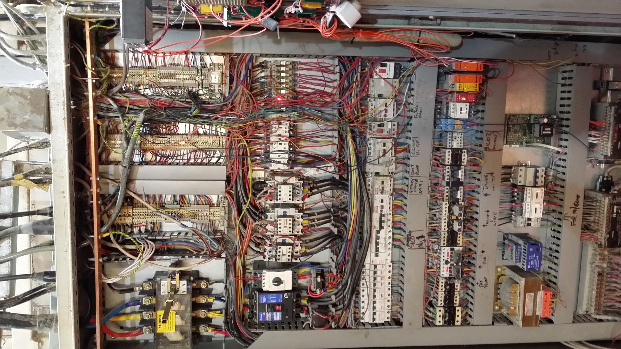

I can tell just by looking at that control panel that several modifications have been made to the original panel wiring, so any drawings within the panel would be of little use unless any changes have been incorporated. Going by the state of those panels, i'd hazard an educated guess that even if there were drawings, the person responsible for leaving a panel in that sort of state, won't be too bothered about updating any drawings!! ....lol!!

Just make sure that if you build a new panel, or do any work on the panel, in the same way that you "must" design and construct the rewire or modifications of the wiring in a house to the current version of BS7671, that the control system for the machine is designed and constructed, modifications or new, to the current versions of the relevant standards, else if something goes wrong, you will end up on the wrong end of an HM HSE investigation.
By the way, if you don't have copies of the standards, then again you would find HM HSE quite forthright in their opinions from my meetings with them.

I think you mean BS EN 60204.
If anything, nothing within the panel will fall under BS 7671

It looks as if it might have been done right the first time.
Trunking, terminals, wire numbers, an earth bar....
It looks to me like it has been extensively modified/bodged over probably a period of years.

As GMES has suggested, my post did not refer to 7671, however, 60204 is not the end of it either, there are possibly a dozen other standards, and some statute laws that must be met also.

Fix the broken bits, a few extra bits of trunking, stretch the wires in, test, it passes.
Think that may be it to be honest Archy. The panel works perfectly well, my 1st main job is to replace the isolator, then as you say tidy wiring up , get some lidding, hoover out .
