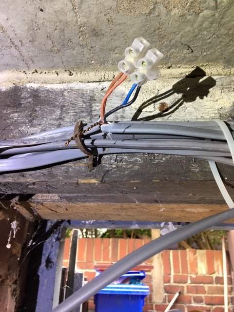

I've got a couple of examples of this;
on a domestic EICR.
I'm on the fence with the coding - C1 or C2. There is no copper showing on the live parts - but I wouldn't like to grab it.
I just want to be consistent with this - I mean if it was just bare conductors twisted together then definitely C1 - but if in a choc-bloc?
I'd be interested to know how others would code it.
Some might argue that it would pass the finger test, therefore c2.
But imo live conductors are visible so C1

I'm going to code the choc blocs as C1.

I would code it as a C2 as it stands.
If this is intended to be within a ceiling void, then C3.
If you are classing as a C1, I would also issue a EDN before leaving site, preferable isolate circuit/s where appropriate and issue Isolation Cert and get the client to sign for them both. If all goes pair shape, back is covered. Isolation cert attached for your convenience.
A good book for EICR is Napits EICR Codebreaker. section 5.17.3 Distribution of final circuits
"Cable connection/joint in live cable(s) not made within an enclosure. Access to live parts Reg 526.5 defect code C1"
