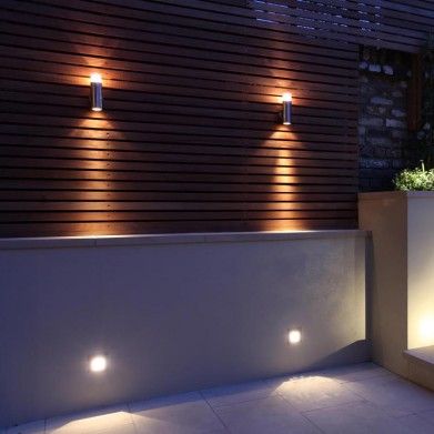

You'll need 230v to make GU10's work, there is no reason why garden lighting cant be mains voltage but it must be done properly, and must be 30ma RCD protected.
