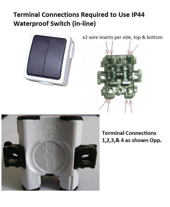

Can anyone please direct me with the wiring of an IP44 Weatherproof Switch (Greenbrook - WNSW2G-C).
I'd like to use double switch unit as an in-line on/off switching unit. Can someone please tell me which terminals I need to connect the Live, Neutral, etc (power supply to each switch will be off a 13amp plug and breaker unit)
All advice and assistance greatly appreciated
many thanks
Richard
OP: Just follow dave's info in post 5 and you will be sorted.
I presume you are wiring the water-fountain and the wall lights from the same circuit?
being a gang switch each side of the switch controls one set of the contacts.
If you look at the diagram on the switch one toggle closes 1 and 3 and the other 2 and 4
Please get a qualified spark to install the switch for your own safety and that of others
The fact is that you are asking this question about something you should already know.
