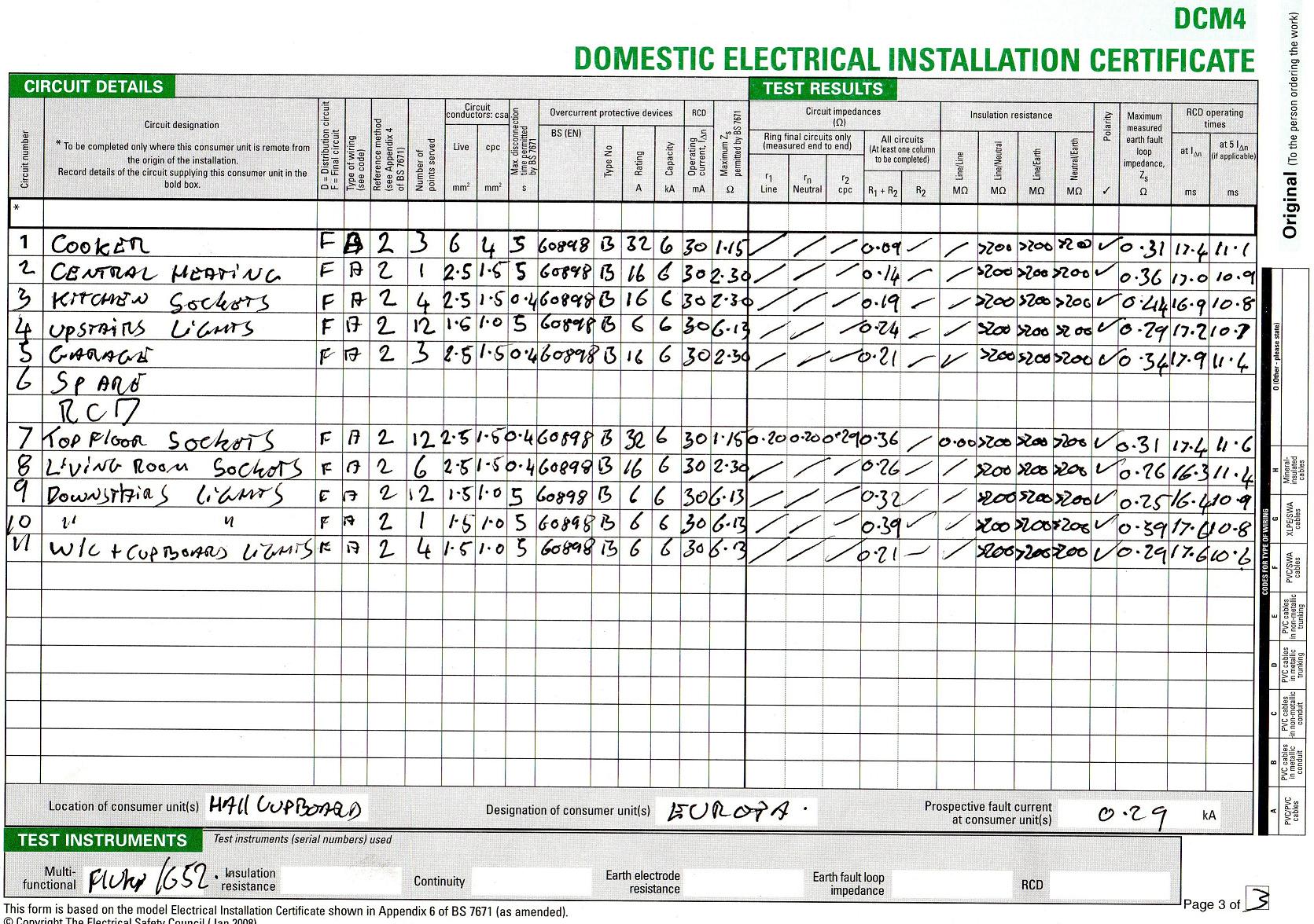

Hi
Apologies for the length of this post but I'd like to provide as much information as possible
We moved house last October knowing that the property would require a full rewire. Our electrician completed the rewire (including new consumer unit) in December last year and although we were unhappy about his reliability at points during the process, we were pleased that the job had been completed and that he had issued a certificate detailing the work done. The rewire didn't include any work in the bathroom or kitchen as our intention was to completely refurbish these rooms at a later date.
That time has now come and we decided against using the previous electrician due to the reliability issues mentioned above A local electrician came to the house last night to discuss our requirements. He had a few questions about the exisiting electrical set up so I dug out the 3 page certificate that the previous electrician had issued. Upon viewing the certificate the electrician commented that the certificate didn't show which body the issuing electrician belonged to. He said that without the registration body information and registration number the certificate would not be acceptable to building control. He also said that the previous work should have been notified to building control either prior to work commencing by an unregistered person or afterwards by the registered 'competent person'.
This set off alarm bells. I've spent this morning online trying to find him listed with one of the registered bodies but he doesn't appear on any of the sites I've been to. I've looked at NICEIC, ELECSA, NAPIT,BSI, Kitemark and Benchmark Certification Ltd (CORGI Membership). Are there any others he could be registered with that would allow him to certify his work?
We had used this electrician on a smaller job (wiring an ensuite shower room) at our old home 3 or 4 years ago and had been really pleased with his work. He had issued a certificate for this work too and also came heavily recommended on a local community website, so we had no reason to think he shouldn't be certifying his own work. Although no rewiring took place in the bathroom, kitchen and garden areas I'm assuming that this is notifiable work because he installed a new consumer unit?
I'm not sure what to do next. I haven't spoken with the electrician yet because I want to get my facts straight first. I'm worried about contacting the council because I've read that they can fine the householder upto £5000 if work that should have been notified in advance hasn't been. I also need to understand what we might be forced to do if the certificate is invalid. Are we likely to have to lift all our floorboards again and reexpose all the cables within the walls ?
This is so frustrating because we would never have had the electrician undertake the job if there'd been any suggestion that he could not certify his own work.
Apart from berating us for being so foolish as to take him at his word without checking him out further at the time, can anyone offer any constructive advice on how we should deal with this situation. Although we've lived at our current address less than a year we want to ensure that we don't have any problems when we come to sell in the future.
Many thanks for taking the time to read this and for any useful advice you may be able to provide.

And I think max allowed Zs's are wrong, as well as what Rappid commented on. And there is something going on with his max measured Zs when compared to the R1+R2 and Ze. But doesn't look too bad. He seems to be a sparky. Just didn't log it with building control. Eiluj68, when you get the next load of works done, get a bloke who will log it with building control and ask him to issue you with a completion cert for the work he does, and register it with the council and a periodic inspection of the works the other bloke. That should cover you. Sort of! did.
Good point JamesBrownLive. I have never seen this mythical Part P Certificate. All I've seen is a piece of paper with my name on it, sent to my customer, from the niceic. I think it says certificate on it somewhere. And something about a 6 year guarantee. But Part P? Don't think so
Good reply from simonspark i would say that would be your best course of action if you are thinking of either extending your house or having a new kitchen bathroom etc at least bonding ,characteristics of your supply would be checked to make sure everything was up to scratch.Armed with a new completion cert that would cover you for future house sales instead of paying labc a shedful of money
Its probably just me, but..... Those RCD disconnection times seem incorrect, cooker excepted.
I thought the only circuits that were allowed 5s times were those over 32a and distribution circuits (411.3.2.2)?
Cheers
Hang on. There are many errors here. PSSC 0,23 KA? That would mean a Ze of 10 ohms at 230 volts. Nominal voltages of 230 and 240 instead of 400 and 230. All the circuits should be 0.4 disconnection time. And crazy rcd disconnection times. 11.4 ms etc. My meter only goes down to the nearest hundredth of a second. Not thousandth. Or is that just me with me old meter? Calibrated mind you!

I'd have to agree with Simon on this one, I believe that when you change a circuit's protective device, that is considered an alteration.
However, this thread seems to have gone off at a tangent....
What started out as a discussion about some of the test results on the attached paperwork has now taken a rather ugly turn.
I do not profess to know it all, or indeed very much for that matter, as I am still in training. All I try and do is ask pertinent questions when I feel I come across a gap in my knowledge, and believe me there are plenty of them.
As I said previously, I have no problem in being told I am wrong.
My main question was one about RCD disconnection times, and apart from Simon, nobody has commented on it. I've said all I am going to re: this thread, if someone wants to comment on my original comment, then fine. Other than that it's off to bed for me :baby:

Get whoever does the PIR to do the remedial work. It’s a bit like an MOT if the garage does the work they don’t charge for the second test.
eiluj68
My personal opinion is that although the electrician may have done a good job, the certificate is a load of rubbish.
The first page under Design, Construction, Inspection and Testing, he filled out BS7671,2008 ammended to 2010.
Every electrician knows there was no ammendment in 2010, the first ammendment to BS7671 2008 comes out Jan 2012 and lots of errors from there on.
As Tony says, get a PIR done.
