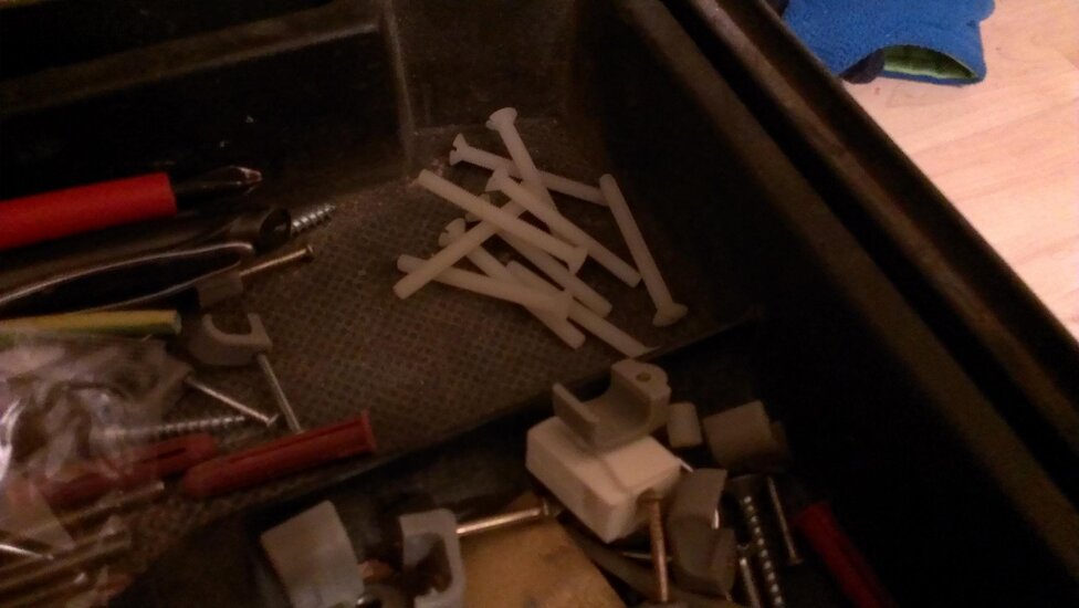

I have one worry with this, and that is metal backboxes with metal lugs, especially in stud walls where if a cable is nipped by a face screw or fixing screw thenyou've got live screws which can be touched
I have come across this in the past. It's ok to say test when finished, but any undue movement in the cable through natural expansion etc, could cause a fault to develop through time.
Sorry, I neglected to say that if you want to do it properly you can use these.
3.5mm x 35 NYLON PLASTIC COUNTERSUNK PHILLIPS M3.5 SCREW NUT & WASHER PACK OF 10 | eBay
I have a slack handful in my fixings box if I need them.
Heres an interesting thought brought on by these plastic screws .
A house owned by a relative has metal conduit and back boxes which are its cpc for its ring main the sockets have no 'flying earth' and use these screws to get an earth to the accessory should a diyer use these plastic screws then the socket would be unearthed .
wonder if any diyer or Electrical Trainee has done something like that ?
