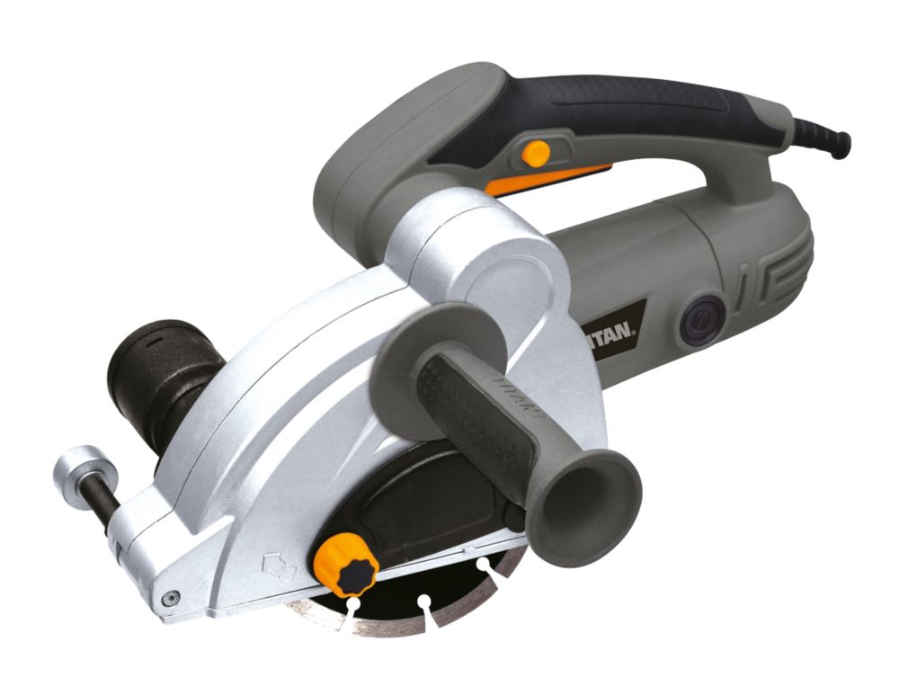

Mine is this one:
Titan TTB293WCH 150mm 1700W Electric Wall Chaser 230-240V (80530)
Cost ÂŁ85
