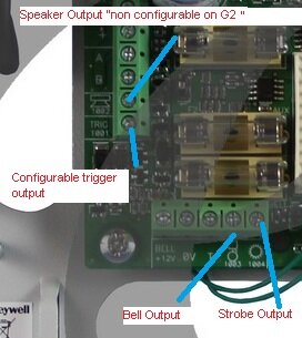

I'm currently trying to wire an 'Informa 8EP276A-UK Speech Dialler' to a Honeywell Galaxy 2-20 control panel. I tried looking in the 'CCTV, Alarms etc' forum but I didn't have permission to post a new topic in there.
Apparently the control panel does have capability to dial out without an external dialler but unfortunately, we no longer get the alarm serviced from the installers (ADT). This means we don't have the Master Reset Code which we need to program the menus. Basically, rip-off merchants ADT will not release the code unless we start a service contract with them again; which is not going to happen.
I have linked an image of the Galaxy wiring diagram and the instructions to connect the Informa dialler for a 'Bells Only' function (that's all we need it for) below:

I can see where to terminate connections for the 12v supply but I am a little confused about where (in the alarm panel) to wire connections for IP1 and INH. There doesn't appear to be a SET terminal in the control panel and i'm also unsure where the 'Bell B-' terminal is.

There is a plug on out put board for this panel but you will not need it for this application.
If you just want notified when your alarm activates, the connect ip1 terminal to the "bell" output, connect your 12 volts and series up your telephone line.
If you want open/close and fire then you will need the output board.
Sent you a private message with list of all the possible engineer codes, and a way to reset it if that fails. Lemme know how you get on i can instruct you further if you have issues with it
Thanks very much to both of you. Timbobelfast, when you say the bell output, do you mean the SAB connections at the bottom of the circuit diagram, where it says Bell +12v and 0V please? The dialler instructions show that I should connect it to the Bell B-; does this mean I should connect it to the 0V (Active Low) terminal? Apologies if this sounds like a stupid question.
If you gain access with the codes I gave you on a G2 you can configure two of the outputs and you can set one to "Set" i.e terminal "1001" and the other to "Int" i.e "1004" which is what your dialler is looking for, you can ignore the fire and pa.
If you do connect it the other way. as timbo said the ip1 termianl gets connected to the bell output which is terminal "1003" which is right next to the terminal marked as "T"

Sorry for not getting back to you sooner; been very busy! Just to confirm that your solution worked a treat, myristate - thank you very much. Haven't had a chance to test the codes yet but then again, haven't needed to.
