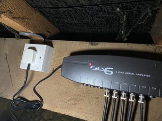

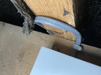

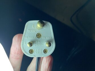

In the loft is a round pin socket already wired, with a round pin connected cable going to a tv arial booster box. The plug says 5A/240V. The cable going to the socket says AEI 167/001.
As each camera is 1.4A, would I be ok to have 2 cameras and this tv booster plugged into this prewired outlet?
I would want to leave the outlet as is with round pins (rental house), but take an extension blog that has normal 13A square pins and put a round pin plug on the end. Then plug the two cameras and booster into this extension.
Does that sound ok? How can I be sure the load on the lighting circuit with those 3 items is ok, to plug into this outlet.

It should be fine they will never overload the circuit. The 1.4A is the adapter power output, not the input which would be considerably less.
If your extension lead has 1.25 or 1.5 flex it may be difficult to connect to the 5A plug so I would suggest buying the parts separate, a four way extension end and some 1.0 three-core flex which can be obtained by the metre.

It is a 5A and not a 13A socket.
Oh..... I get it, OK. Yep..... just get a flimsy cheap 4way and the cable will be a piece of string anyway ?

The cables will be different, a 1.5 cable is thicker than a 1.25. The 1.5 will take more current. You don't need a new 5A plug as the old one can probably be reused. You will need a 13A plug for the aerial amplifier once the 5A is removed. You can get a surge protected lead but I think you will struggle to get the fitted flex into that 5A plug.
You can get separate ends without a flex like this then get a metre of 1.0 flex.

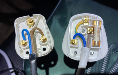

Just been up on the loft to look ? Plug on left is 5A round pin, no fuse and no earth. On the right 13A connected to extension.
I'm ok to swap these over? Do I just wire the earth cable into the top pin to match and it should all be ok? No issue having something wired into earth pin connected to lighting circuit plug?
thanks
Yes connect the 5A exactly the same as the 13A. It is assumed the 5A plug has an earth connected and this is required for your new extension lead.
