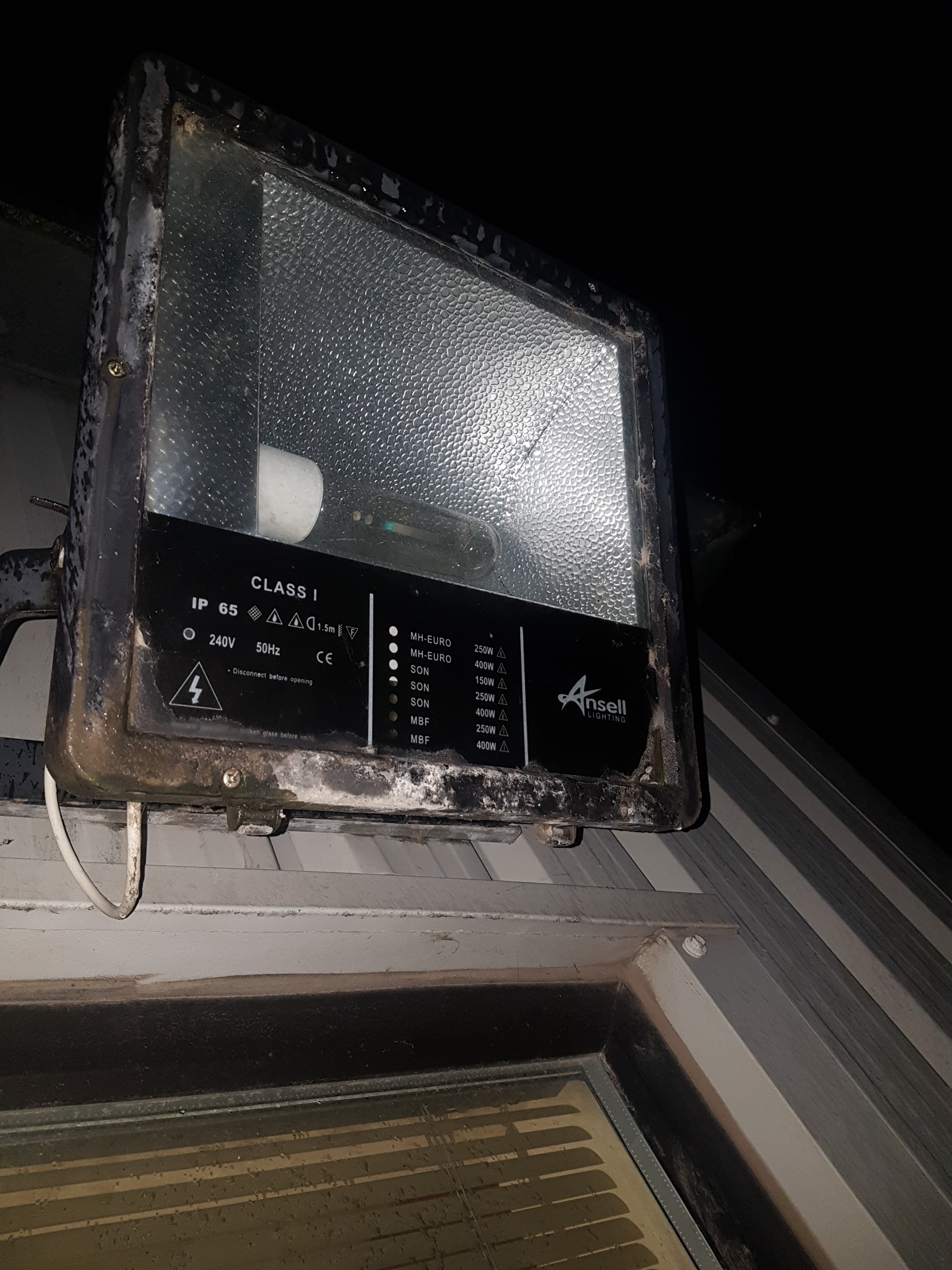

I have leased a warehouse for about a year now and have had an issue with the external floodlights.
There are about 12 in total that come on when its dark. Each one turns on, warms up, then at their full brightness turn off. This happens every 5 minutes or so. Each light does this but not simultaneously. Kind of one after the other in some strange sequence, a couple maybe at the same time, but the same cycle nonetheless.
Is there a setting that would cause this, or are they likely faulty? I just want them to come on and stay on until morning for security.

They sound like metal halide fittings and you could be getting what is known as end of life cycling with the tubes. Replacing the tubes may rectify this however this maybe a short term fix and it may start again. Halide tubes as they age require a greater load to maintain their illumination and this can have a knock on effect to the ballast and capacitor, in particular the capacitor. If damaged it may no longer limit the power to the tube and hence cycling may begin again. Being twelve years old you may want to consider complete replacement.
I have to agree with @westward10
Seen it myself with end of life lamps also the fact that they turn on and off in sequence tells me that they are not on one photocell to control them all and even if they have they're own cell each all the cells can't be faulty or very unlikely anyway. Most probably lamps.

Thanks again for the replies. The whole sequence thing is really strange. I am going to review CCTV to see if its the same sequence each night? I have uploaded a photo of one of the fittings leaning out the window.
Those are SON lights which give out orange light! Almost certainly ageing lamps causing the problems.
Honestly theres no need... As a few of us have said, this is what those type of lamp do at the end of their life, grab yourself a couple of replacements (size will be on bulb)

The arc tubes look to be blackening toward each end, a sign typical of end of life, as suggested by many posts on here.
I suspect that fitting in your pic may have water laying inside it.

Is that an e27 thread ?if so you can get led lamps that will fit though it does involve bypassing control gear,an easy job,lamps expensive but less than new fittings & labour.
Had this issue years ago on a old mod building and it was caused by individual photocells in the fitting reacting to light from other fittings switching them off and on as each light heated up and changed lux levels. If possible try disconnecting photocells and see if lights stay on just do a couple as test and go from there
