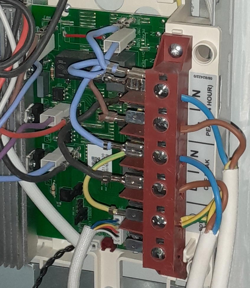

Hi Guys,
Had a call out today about an odd issue with a newish Creda DT storage heater.
Basically..
Storage heaters were installed in one flat and connected to two separate CU's each with RCBO proptection and were working perfectly.
These were then removed and installed in a flat in the same block, and this time, 24hr supply is connected to a new CU with RCBO, and (for some reason) OP side connected to an old rewireable CU that was not changed.
Problem is, whenever the OP isolator is switched on ready for charge, it instantly trips the 24 RCBO.

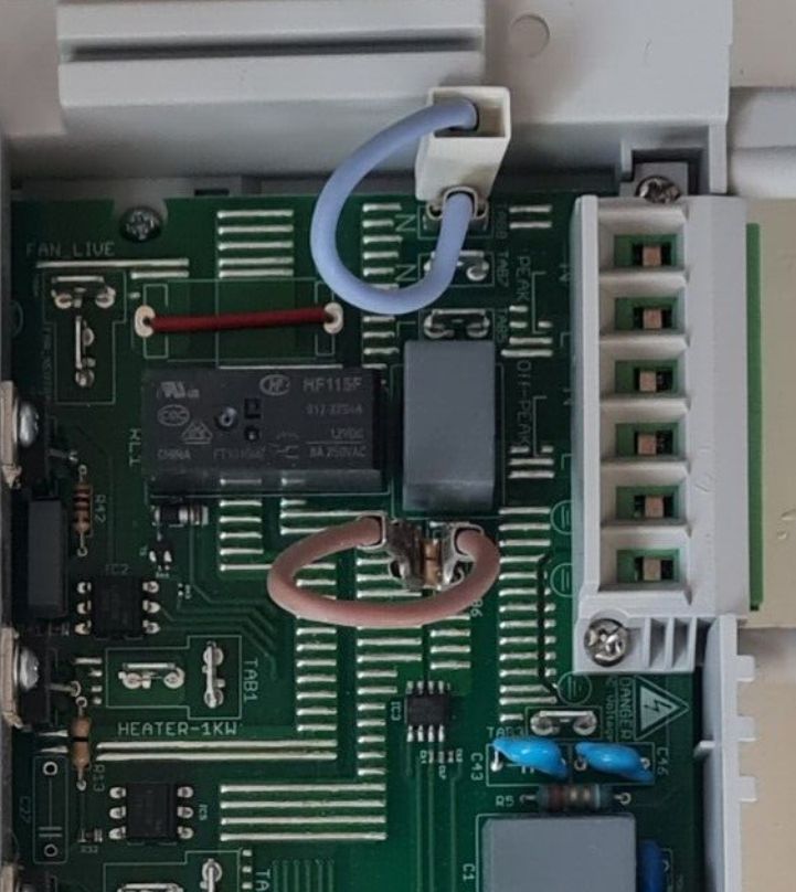

After doing a bit more investigating, it turns out the 24hr supply is back feeding up the OP side. Each set of terminals on the main circuit board seem to be permanently connected which is causing the RCBO to trip due the the two neutrals being 'connected' in the heater. Also, the heater elements are engergised via the 24hr supply as well which cant be right?
So, there was still an unused heater in their store room so i swapped out the circuit board from that unused one and it still had the same issue.
Its a Creda FWIW.
Ill attach some pics
