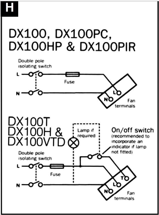

Bathroom extractor fans with built in PIR (Xpelair DX100PIR Extract PIR Timer Fan Kit) I cant find any info on it but I am assuming these just need a supply taken from a local lighting circuit but with a permanent live rather than a S/Live (L/N/E)?

Yeah just LNE via a double pole switch or fused spur depending on what the MI say.
DX100 PIR wiring diagrams, the PIR operates for a time period after sensing movement.
If it does have an override you need a SL and PL.
