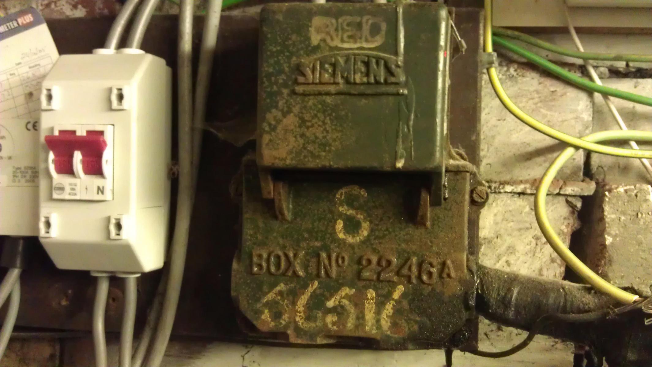

I will be installing a new Ring main for a kitchen install and have come across a cut-out that is totally new to me.
Has anyone seen one of these..and how do I record its details on my Certificate.

If you are referring to the supply protective device, then for a domestic supply, it is usually, but not always, a BS1361. Could be a type IIb, but unless it is marked on the casing, then you either ring up the DNO, ask them if they know (unlikely), or put down N/A or unknown.
You will be installing a 'ring final circuit', not a 'ring main'.
Google it, and see what the difference is.

Most likely 60A rewirable going on the size. Wouldn't be surpised if it isn't a fused neutral. Thats an old DC head.
Get the DNO involved.
