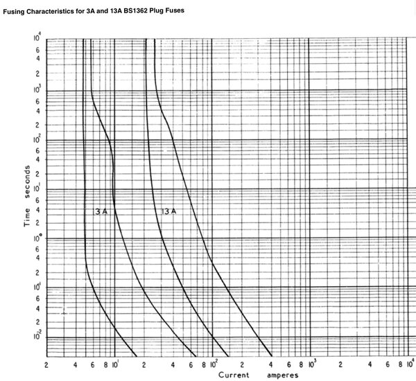

Hi,
I have a fault somewhere on my immersion heater circuit, the 13A fused spur switch is getting hot & there is visible insulation damage to the live conductors only, the fuse in the spur is where the heats being generated, I disconnected everything & tested the resistance of the element alone, its a 2.8KW rod & I recorded a value if 18.5 Ohms, Fairly normal for an element that size, I thought!
The circuit is governed by a 16A MCB, through a 80A RCD unit, on a duel RCD fully loaded board, I tested the functionality of the RCDs & both are operating as normal, I am suspicious the fault is the element, but with no faults to Neutral or Earth, I'm a little perplexed! The property was EICR tested only 1 year ago by an NIC EIC registered company, so all the continuity values, IR readings & loop impedance have been recently checked.
Any help would be brilliant, I don't want to pay for the element to be replaced & find out It wasn't a fault with it!

This is the 3rd one in a row with the same fault then, as EICR company changed it out for the same reasoning (ie it was a faulty switch), then it began to heat again, so I changed it out after testing the elements & RCD function & began to pull heat to that fuse again, Can it be possible that 3 switches in a row have the same problem, or is it more likely that the element is drawing above its rated amount, even if so, why is the fuse not just blowing? Why is it getting so hot that its melting plastic but not breaking continuity?
Your answer is in posts #2 and #3. Change it out for a 20A DP Switch.
Fuses blow by getting hot. Run a fuse close to it's rating (which you are doing) for extended periods of time and it will get hot, but sit there quite happily.

This is the 3rd one in a row with the same fault then ... or is it more likely that the element is drawing above its rated amount ... why is the fuse not just blowing? Why is it getting so hot that its melting plastic but not breaking continuity?
A couple of thoughts :
- maybe all 3 are carp brands? But from what I've seen I'm inclined that none of them are any good for 13A continuous nowadays.
- a 13A fuse definitely won't melt at 13A but will be warming up for it :)
