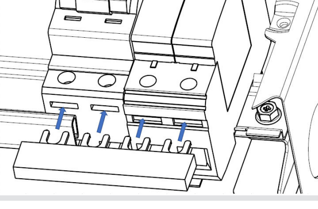

I’ve attached photos and the pieces that I believe should go there. One is too big.

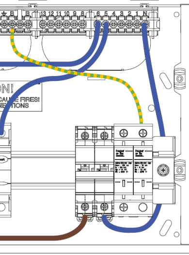

What I noticed on the DB, if you look at the SPD on the right of the main Isolator, at the bottom side the N busbar link is bare, like the plastic cover was cut. I know that it doesn't come like that from the manufacturer.

@westward10 my understanding is that they look like this - and I'd expect to see some glimpse of the CPC .

I fitted a hager SPD board 2 or 3 months back. I recall it being configured strangely, it came with the link across the top, but IIRC it didn't have a CPC connecting it to earth, I think it made the connection via the DIN rail. Basically as in the picture in the OP.
Here's a photo, there was no CPC. I feel like I should go back to the job now to confirm that it is connected to earth via the din rail.
I actually thought it was defective at first, because of the vaguely red window (I'm sure older hager SPDs had a green window when ok), so contacted Mastertrade, who helpfully forwarded info from hager explaining that it will go solid red when expired.
It's taken some concerted searching, as the numbers on the front are the cartridge numbers SPB015 and SPB105N.
I believe the whole assembly is knows as VME02SPD, and the instructions (which also mention those cartridges) show a CPC connected. But it wasn't easy to find this.
The board I fitted came with the SPD already installed, with the solid link across the top. I wish I'd taken a closer look at it now, but it was a difficult board change that ran on into the evening (you know those ones where every single thing about it is difficult), so I didn't pay it a great deal of attention .
I might check this with Hager
I'd certainly be interested to know the outcome. I've only ever fitted one of those and had to add the module myself, and it came with a bit of 6mm CPC that obviously I went looking for a home for.
But I've seen a couple on EICRs and may have messed up myself as my photo of one of them doesn't have a CPC connection.
I'm wondering if some sheds are assembling the populated boards themselves and getting it wrong....

Indeed, if a professional, namely an electrician just quotes for a dual RCD board, then when I'm looking at Hager, why would I think hey, i'll buy these too- additional expense. If the quote was for RCBO's i'd ask what they are, the benefits and clearly a lot of the members on here suggest they should be fitted then I would have gone with one.
