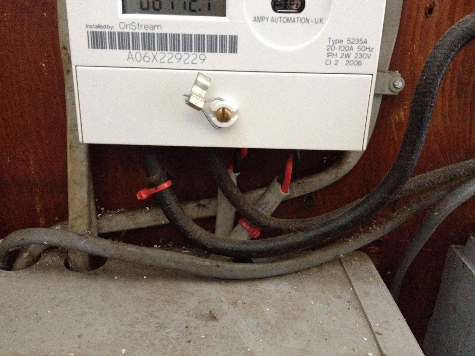

Talking about tail sizing, what do you think of these....
image.jpg Yes, 2.5mm doubled up so, 5mm tails!!!
Reactions: 8 people
...Nice twisting,and respect due for red zip-ties,having noticed the only potential risk being conductor identity :conehead:
