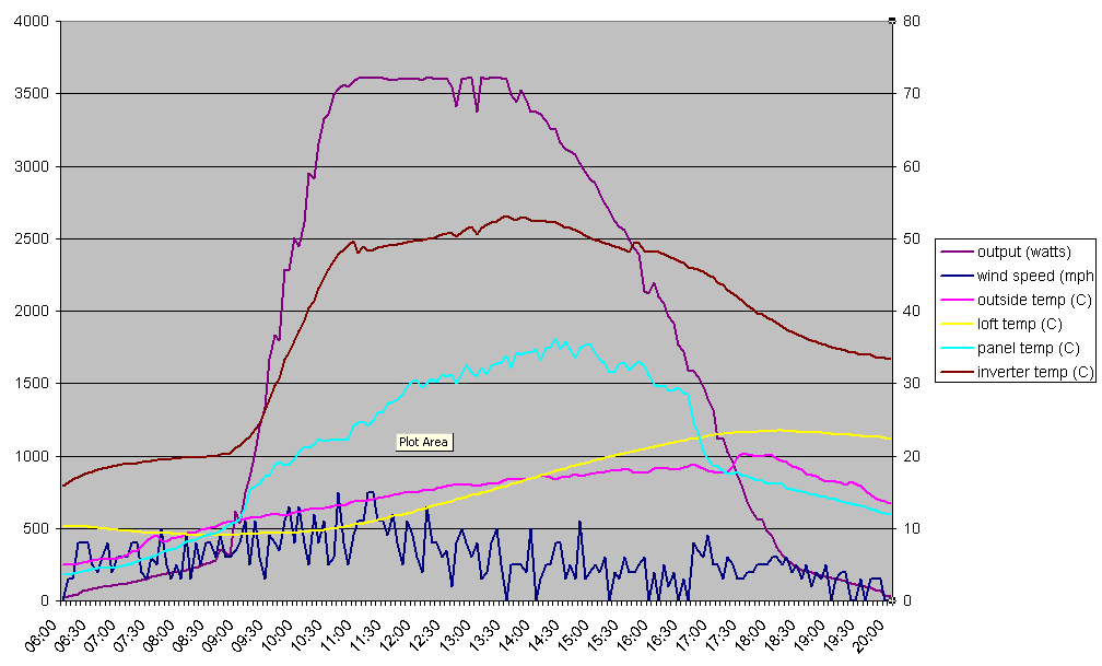

Many system owners have probably seen changes in the performance of their systems between spring and summer. The days are longer and the sun is higher in the sky but it's also warmer and the sky is a bit hazier.
I have been able to collect various pieces of data on my system and have graphed them and thought I would share the results. First, the system is in south east Hants and faces roughly 170 degrees on a roof with a 40 degree pitch. It's 16 Sanyo 250w panels with an Aurora PVI-3.6-OUTD inverter. It's one of the later ones where the output is limited to 3.6 kWh.
Each of the 2 graphs shows the system output measured in watts as a purple line against the left axis. Against the right axis is the wind speed in blue (the zig-zag line along the bottom), the outside temp in pink, the temperature in the loft in yellow, the temperature on the back side of the panels in teal and the internal temp of the inverter in brown.
The first graph is from 2 May. Maximum temp during the day was about 18 degrees (ignore the rise to 20+ around 18:00 as the temp sender was exposed to the sun). The power output stayed at 3600 watts for quite some time due to a combination of cooler weather, a nice breeze, the angle of the panels and what was probably a clearer sky. The panel temp peaked at about 35 degrees. Note the loft temp temp peaked long after mid-day. I think the panels shaded the roof until late in the afternoon when the side of the house started to bear the brunt of the sun so the loft heated up. Internal inverter temp pretty much corresponds to power output. Total power for the day was 24.7 kWh.

Questions and comments welcome - will try my best to answer them.

Interesting information, thank you. I have the same Aurora inverter and also find a difference between spring and summer, but more marked. my panels are maxing out at 3KW over the last few days, whereas in spring they go right up to 3.6kw (3.92kw panels). Temperature obviously has a key part. I live on a busy road and the panels get dusty, when I cleaned them earlier,power shot up to 3.3kw and then slowly dropped back down again to 3kw over the next 15 mins as they next warmed up again. I would be interested to know what products you are using to capture the temperature information as I would like to do some similar work for my system too.
I have an idea to overcome the 3.6kw limit on the Aurora inverter, if one or two of the panels are moved off the inverter to micro inverters, this will create capacity on the inverter and possibly reduce its temperature as well. From the manual, the aurora begins to limit output once the Temperature gets over 50 degrees, so could be a big win. I haven't done any cost calculations but that's not so important for me, If I have a 4kw system, I want to get 4Kw out of it!

Whilst inverter de-rating over 50degreeC can have an impact, what you are more likely seeing is the impact of temperature on the module's voltage and power output - it's an inversely proportional relationship to the temperature and some panels will drop their voltage/power output more per degreeC increase than others....
Thanks for the comments so far. The inverter temperature is as reported by the inverter itself and represents its internal temperature. As far as de-rating goes here's an extract from the manual:
"For ambient temperatures below 20°C fans are off . No power derating.
• For ambient temperatures between 20°C and 25°C there is no power
derating. Fans are turned on and off according to a pre-set cooling
profile.
• For ambient temperatures between 25°C and 40°C there is no power
derating. Fans are kept on at a variable speed depending on
temperature.
• For ambient temperatures between 40°C and 55°C there could be a
power derating, even with the fans at max speed, with a minimum
output power of 2500W when temperature reaches 55°C."
As the ambient temp is only in the mid 30's there shouldn't be any de-rating occurring. And if there was I would guess a step-change in the output would be visible.
The other three temperatures are measured with an old Oregon Scientific weather station. I think the senders are accurate to within a degree or two. One sender is held in place against the back of a panel; when I checked the temp of the front of the panel with an IR thermometer they were within a degree of one another.
According to Sanyo's data the panels should only produce about 6% less power at 44 degrees than at 25 degrees so 4 kWp of panels should still produce roughly 3.76 kWp. I suspect the hazier sky is having an effect. And I should calculate the best roof pitch for those 2 dates and see how far off my roof pitch is.
