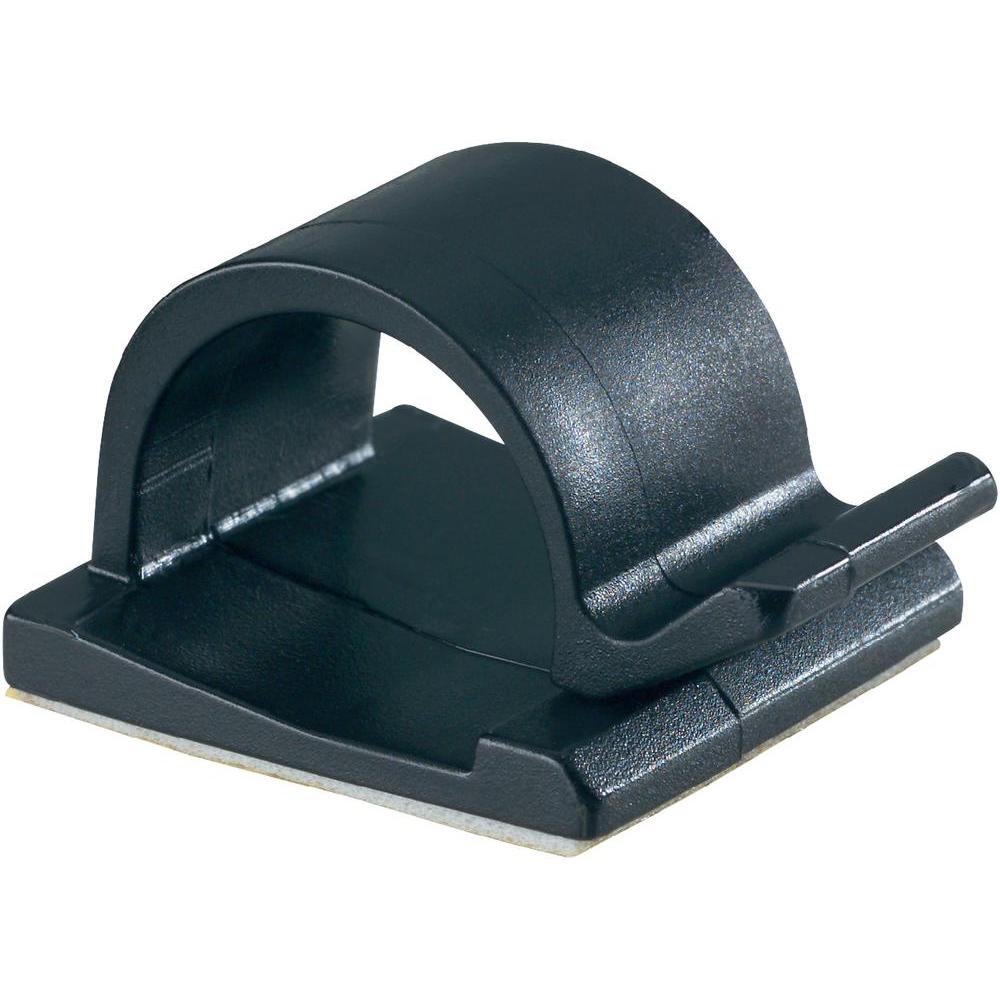

Would you be able to fit cable clips like this
or this
and glue them under the tiles and push the cable into place.
or use silicone sealant that would be a nightmare to hold the cable until set but easy(ish) to remove or use cable tec glue that may not hold very well but should be OK for outside.
