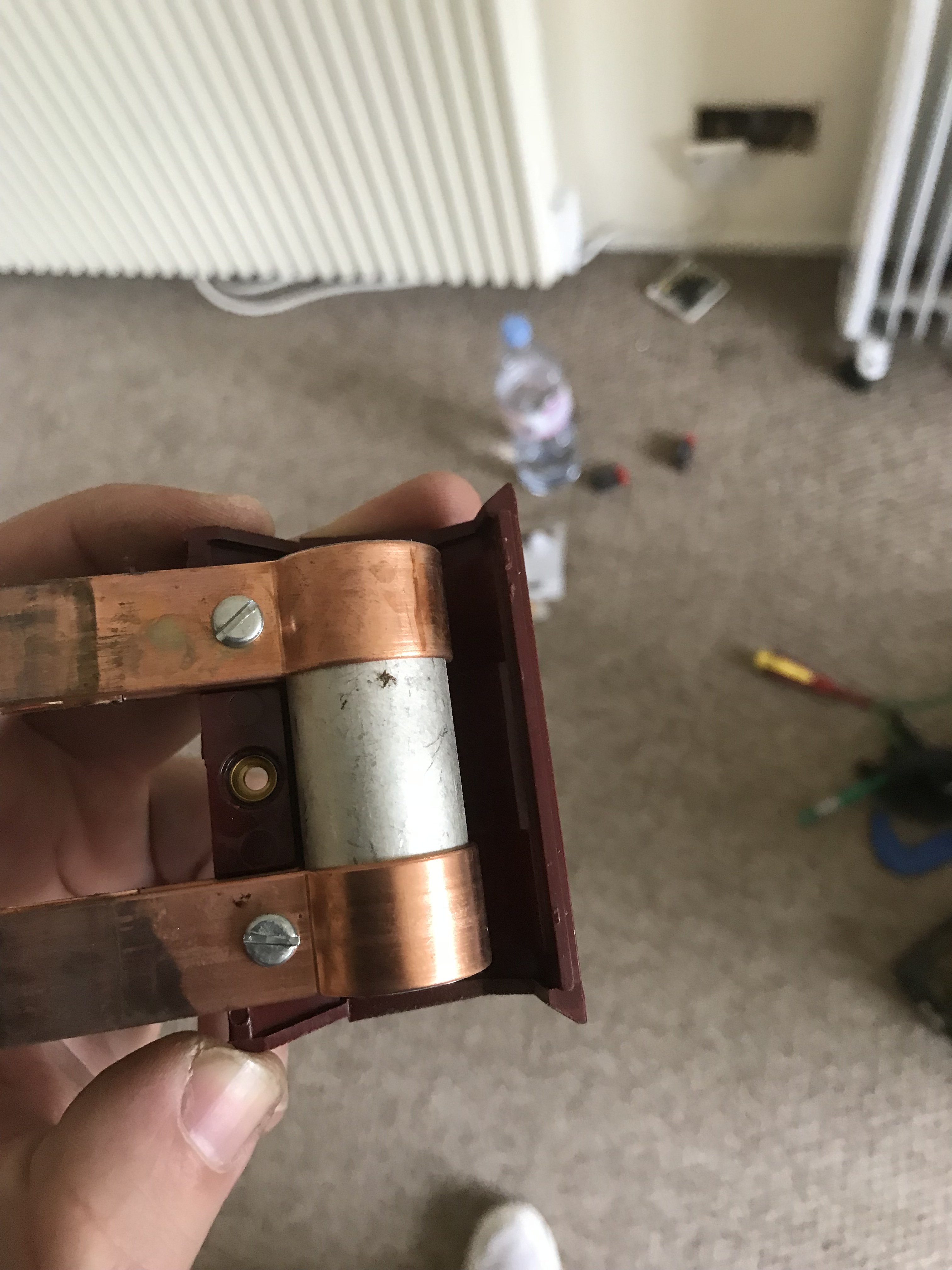

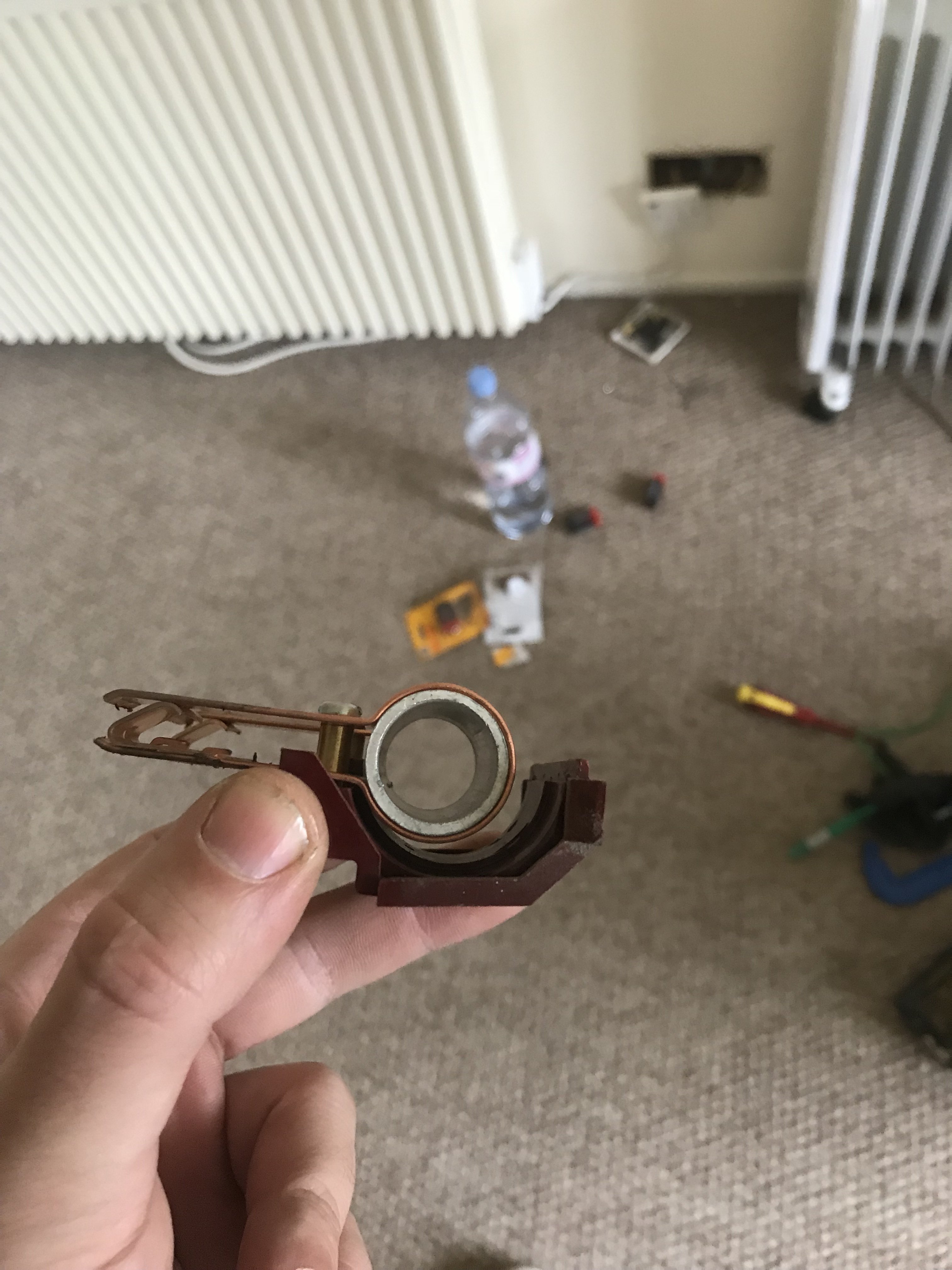

Evening all,
I was doing an eicr in a flat today, it came to checking the main service fuse.
Fuse pulled I proceeded to undo the case to check the amperage and was a little shocked with seeing a metal bar essentially bypassing the fuse(pics attached).
After a little thought I guess there is another fuse down below removing the need for a second fuse.
Anyone else seen this before and know the name of the part used? Or is this a one off
That is a Redlink it is a link not a fuse.
Yes.
Is it in a block of flats.

Is it common practice or required now to pull the main fuse on an eicr or am I doing it all wrong again!?
For any standard electrical work including EICRs: It should not be common practice, it is not required, it is illegal, it is dangerous, to pull the fuse.
In this case luckily he has not pulled the fuse as it is just a link!
Just as dangerous though.
Where there are two service heads in series on the single supply it is redundant to have a second fuse so a link is used instead at the downstream service head.

I've found 200 Amp fuse in the suppliers fuse holder in a domestic installation. Probably followed the logic of if a fuse blows fit a bigger one. Since both the EIC and EICR require one to state the type and rating of the fuse, how can you be sure it is as expected, without removing and opening the fuse holder ?
But it was only a fuse I put back and it was fine when I left.
Arrgh just pull the fuse and put the seal back in afterwards, and then crink it a bit. No one will notice. :eek:
DNOs must vary on this. ENWL do not allow interference with main fuse by private electricians. Seals are there for a purpose
You are not authorised to work in the incoming mains, it is not part of the installation, and is not covered by BS 6761. You did of course re-seal it afterwards, and wore the correct ppe and worked to the relavent code of practice as issued by the DNO? Again it's a big joke to interfere with the supply equipment, but look out anyone who does a bit of wiring when they're not qualified. I suppose next you'll be in the sub-station checking the lv board out.

SSE allow us to pull the fuse.
If a customer phones for an isolator they tell them to get an electrician to do it.
The idea of not being able to islolate the supply is utter bollox.

Have to agree that on an EICR you shouldn’t be pulling the bullet. If you’re not sure it is as stated on the cut-out by supplier just LIM or NV your report?

SSE/Hydro around my parts allow NICEIC Approved contractors to pull the main fuses subject to wearing the appropriate PPE. I think it’s written into their own internal guidelines?
SSE told me anyone registered with a scheme can pull the fuse,but I don’t think they have any kind of sustain place to check anyway
Reactions: Gavin John Hyde
apparently if you pop in the sse depot to pick up sticker seals they check with the scheme you are a member when you phone to arrange this. you have to give addresses of said fuses. if you cant give address they limit you to 10 seals and then when you give addresses you get another 10.
I use metal wire and crimp seals. and they were fine to let me use these. they said no need to let them know then but if in doubt about the fuse or its old/stiff give them a call to do it.
