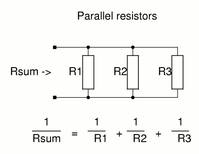

A number of cables are tested for installation resistance. The highest individual value is 200M ohm and the lowest is 20Mohm. The measured value, when all cables are connected in parallel, will be?

Work it out what is the total resistance of 200 M ohms and 20 M ohms in parallel. This will answer your question.
When working this out remember that you are measuring resistances in parallel.
The total resistance of resistors in parallel is XXXXer than the XXXXest?

in a parellel circuit the total restistance is always lower then the lowest resistor so in this case the lowest is 20m so it will be lower then that.
if you are a trainee apply for the trainee section and we will all try to help you
parallel resistors
total resistance of resistors in parallel is lower than the lowest individual value
