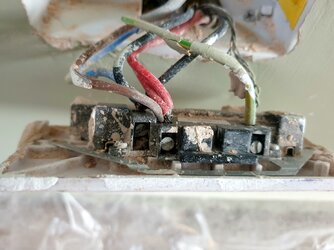

I had to replace a surface plug socket box after the plasterer destroyed the old stuff.
It has black, red and earth wire, 3 of each and look quite thick (the earth wire looks like it should be used for barb wire abd isn't covered)
Sticking all of that into a new faceplate isn't working so well and there's not much slack
Can i put the 3 wires of each type into separate wago connectors and have 1 6mm wire go to the faceplate from the 3 wagos
The fuse seems to be 32amp mcb
Thanks for the help
Sounds like a standard 2.5mm rfc with a spur coming off…. Or could it be a mid point of a 4mm radial circuit with a branch off?
Either way, it should be ok to get 3 of each into the socket… although some sockets may have smaller terminal openings which might be where the issue is here.
Using Wagos in the back of the box would work, but some would argue it’s two spurs off at the same point…
And make sure the bare earths are sleeved in green/yellow, separately.
If the cable is actually 2.5 or 4.0, not 6.0, why not use one of MK's finest 🤪 The 'Wago's' are already there!

It is normal to have a 32A breaker on a 2.5 ring final circuit, which is likely (but not guaranteed) to be what you have.
But I would be very surprised if the cables you have are actually 6.0. Could you tell us either the diameter of the copper, (L or N) or the overall width of the grey sheath?
You can use Wago's if you wish, but you only need to use 2.5^mm cable to wire the socket to the Wago, because the load you can plug into the socket is limited. (the 13A fuses in the plugs take care of that!)
PS you need to put some green/yellow sleeving on the bare earth wires Edit - sorry -that's been mentioned by littlespark already!

Theres a pic of another socket thats about the same (except the other has no blue or brown)

From the pic I'm thinking the cable in new colours (which has sleeving on the earth) is 2.5, but not sure about the red/black.
I don't understand what I'm seeing at the ends of the red cable, as there are shiny strands of what I assume are tinned copper wire (could poss be aluminum?), but as well some dark copper burned looking thicker gauge strands that aren't anything to do with the brown cable. Is the dark stuff what's in the red cable? I guess it's imperial size!
I'd be inclined to take the L wires out and see what you've got, cut off damaged ends, strip the appropriate length for the terminal, make all the strands straight and parallel and see if they will push into the terminal of your new socket. I've never been a believer of twisting wires together before you put them into a terminal, they should just slide in!! Assuming the terminal is big enough🤔
Otherwise go the Wago route, but I'm concerned you may not have room to dress the cables in.
Ill get another picture of the actual socket and clean/straighten/strip some of the existing cable and show what i do with the wago. If it fits then all cool and confirmation from here would be good.
But you can also see what the existing cables are and possibly shed some light on what type of cable they actually are for future reference.

As long as you strip the wires to the right length, they are clean, and you give a bit of a "tug test" in the Wago to make sure they are seated, all should be well.

I'm no expert on older cables, but I would say date is 50's to late 60's. Hopefully someone who knows might be along.
I'm assuming they are tinned stranded copper, with polythene insulation, but will be clearer when you tidy them up!

You could always disconnect the brown/blue cable and see what stops working!
Be careful though - there's a tiny chance that's where the power is coming from!!
