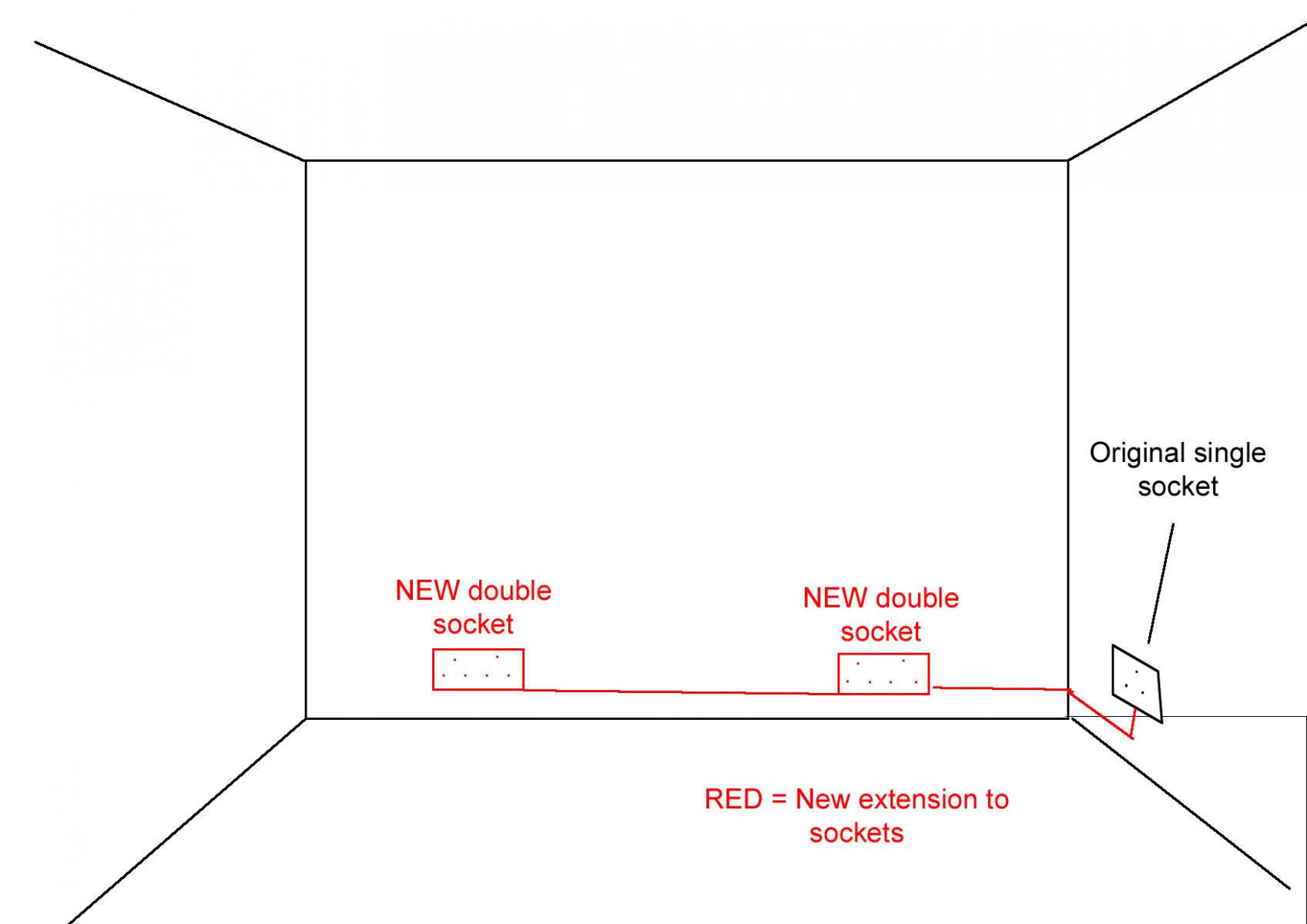

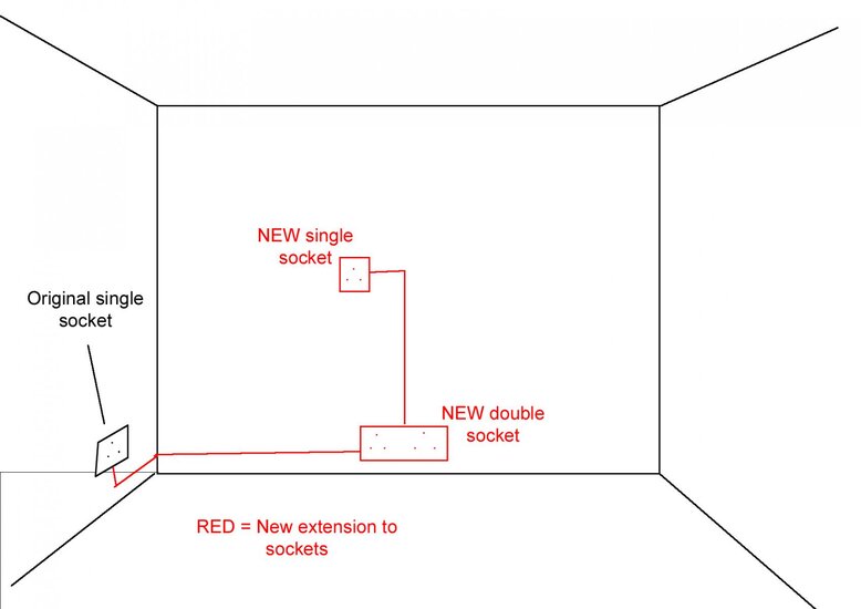

liam, i'm trying to visualise what you have got there. it looks as if you have run sockets in a spur off a ring. how manynew sockets?
if you are coming off a ring, fitting a Fused Connection Unit at the point where you connect into the ring will solve the issue. if the existing circuit is a radial, then you,ve no problems.
suggest you post your location, and see if a forum member is close to you .
I posted my local (hastings) Have done two extensions,(still not connected) one in my lounge coming from an original single socket, with one set of wires going into it (in the single socket coming from the back already there), spurring onto 1 double socket below TV and then going up to a single socket directly behind TV on wall and the other in my bedroom again onto a single socket but with two double sockets off it. Both extentions where made with a 10m reel of 2.5mm t+e so roughly about 5 metres each
Hope that makes sense, I can make a drawing if it helps, although it wont be a technical schematic, unsure of the lingo.
Many thanks
a pic. would be helpful. try and make it large enough for my tired eyes.
Many thanks
Hi,
The problem you have, Liam, is that, if the two single sockets that you are spurring(extending) from are already 'spurs' off a 'ring final', then you can't run your 'extensions' off them.(unless they are fused spurs)
If they are radials - then fine - but I assume you have no way of confirming this.

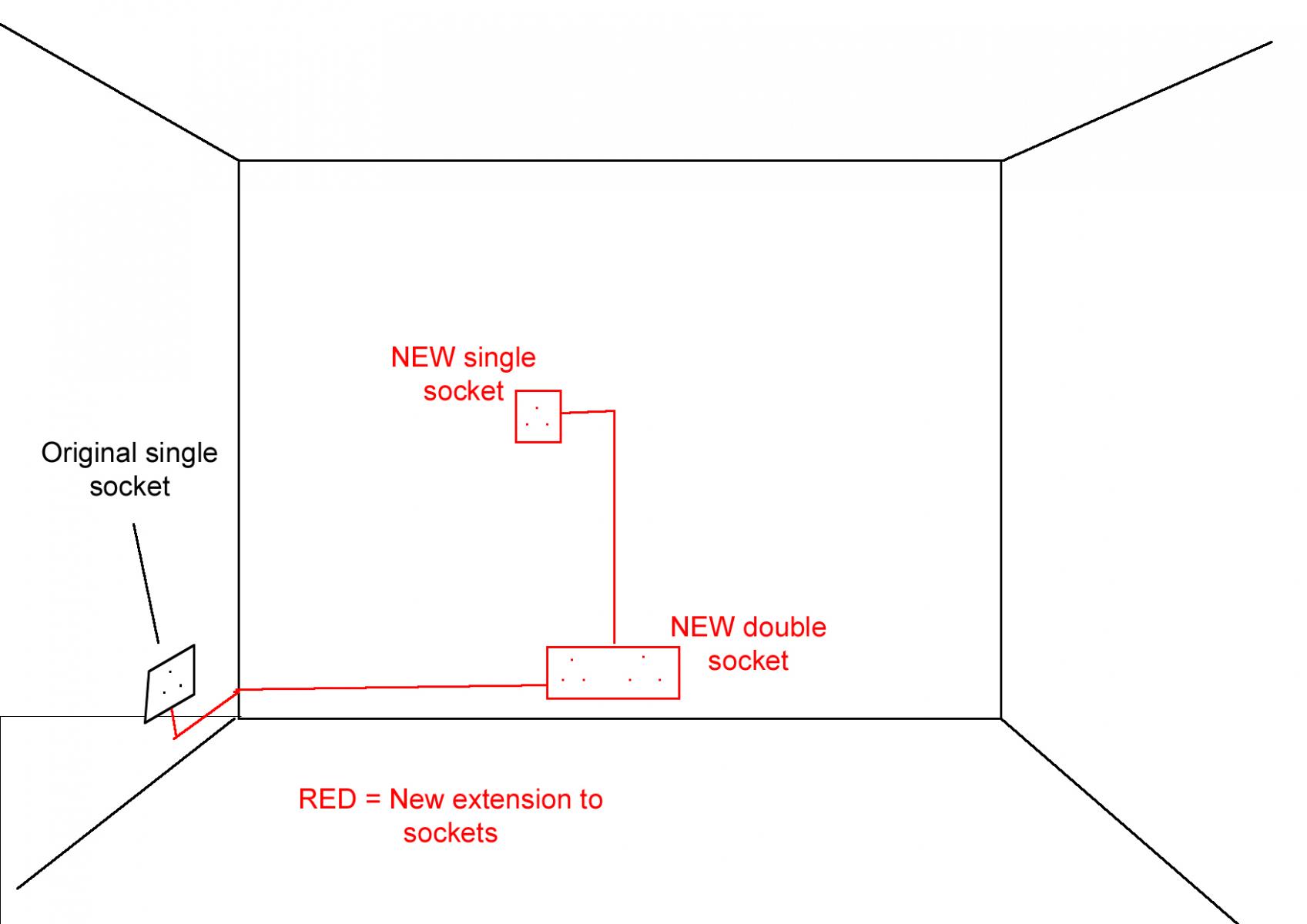

I have included a drawing, Its worth mentioning that the lounge only has two live sockets currently and this is how its always been, 1 single on one side of the room and 1 double on the other, The bedroom is exactly the same 1 single socket and double, and as the single socket was the closest to the point i wanted to install extra sockets it made sense to try and spur off those.
BEDROOM
LOUNGE
The other existing double sockets is on the wall behind perspective drawing, both doubles as mentioned.
Many thanks for your input
Even if the existing socket was not a spur, but part of a ring, as per the regs you can not add 2 double sockets spurred direct of the ring.
Again if you have radial circuits, unless by some stroke of luck the sockets are the end of 2 individual circuits, you can not add 2 double sockets spurred direct off the circuit.
There are other factors as well the work you do will have to conform to the current regulations. I didn't see your other thread, but in this you don't mention RCD protection for your existing sockets, your new sockets will have to have that as they will be classed as sockets used by ordinary persons.
If you bury the cable then unless you bury it deeper than 50mm or have earth/steel protection on the cable that also needs RCD protection.
A way of doing this is connect new sockets via a RCD protected FCU. But before all this can be done you will need to see how those existing sockets are wired.
I don't know if it's just the sketchy diagram but those cable routes look somewhat 'all over the shop' unless of course that's not what you wanted to hear in which case they're fine.
Sorry, I dont know what you mean "all over the shop" I thought they were quite neat, in straight lines 5" above the floor. :confused::confused:
Not in the picture they're not - most go horizontal, one goes vertical, couple of right angles and they appear to go around the corner of the room.
An unfused spur from a ring must serve no more than ONE twin socket.
A fused spur from a ring (max 13a) may serve an unlimited number of sockets.
Buried cable must be in a safe zone...that is in line vertically or horizontally with an electrical accessory,or within 150mm of the ceiling, or within 150mm of the angle formed by two walls.
Liam I suggest you buy a copy of bs7671 before doing this, or the onsite guide, think about it.....how would a joiner know were to hang his shelves around diagonal cables?
There are no diagonal cables, maybe its just my crappy perspective drawing that makes it look like there is, only horizontal and vertical cables, (and I used a level!):o
Well maybe ill turn the single socket Im coming off into a 13amp fused spur, its hidden behind a bookcase and wardrobe anyway. Lets see what an electrician says first.
