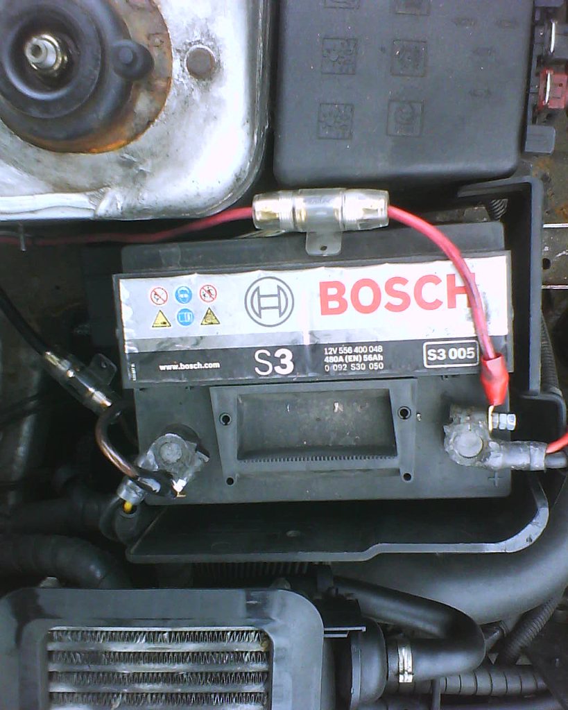

Remember a fuse is only a fuse (Cheap & easy to replace), how if you don’t fuse a lead, and resistance and/or maximum is exceeded, then wiring looms and/or motors/parts and expensive & hard to replace
Why would you want to fuse the negative as well as the positive
A circuit will be disrupted with a fuse in the positive only,adding another fuse in the negative has no benefit,its a waste of time and effort
Some starter motors can draw current upwards to 200 amp and will operate directly from the battery via the solenoid,
If you double fuse everything ,does that "everything" include your starter motor
Using thick cables to overengineer for heavy future loads
Relays and solenoids negate the need to switch the bulk of these loads,localised larger cable is the time tested best method
