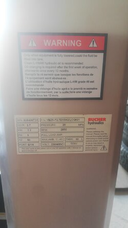

Thanks for the quick reply mate at this time 12am lol. Sorry i think I have misguided you about the 16a. I have attached the picture of the lifter for your consideration.

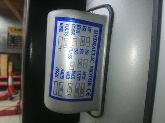

I ll upload the manufacturer's data picture tomorrow from the 2nd ramp.

This a 3 phase lift according to the rating plate. It will need a 3 phase supply.

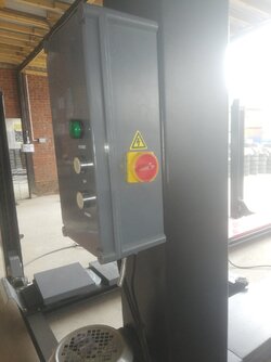

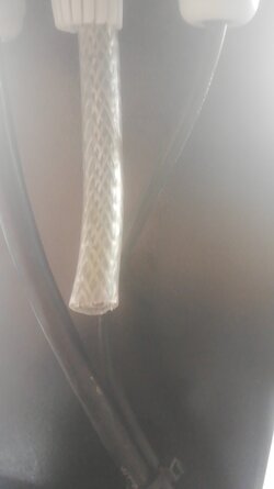

The customer has actually said to me that he has told the supplier to install single phase lifter as you can not see properly in the picture but its got 3 core SY coming out from the isolator. which the installer cut it for no f..k reason

I'd have gone 2.5/4mm radials to a rotary isolator for each lift, 2.2kw? (can't make out that picture fully) should be a dedicated circuit.
Lot more to this though, outside, circuit length, route????

Its actually going to the isolator built-in. Its just ring 2 x lifters clipped on the wall, about 20M long run
Yes 2.2kw each.

I'd be tempted to do two 4mm radials on 25 amp C type MCBs to 32 amp isolators. As the circuit is clipped this will give the future option of upgrading to 32 amp circuits if required. Isolator rather than Cdo Skt as this will negate the need for RCD if installation method permits.
As this is a workshop will the cable require mechanical protection?
Note the 2.2kW is the mechanical power output (P2) i.e 3hp. The electrical input apparent power will be higher due to both efficiency and power factor. Whenever possible, work from the stated line curremt which is shown on the plate as 20A; the starting current will be higher. 13A plugs would not be my choice of connection.
Are the two ramps identical?
Are the two rating plates on both machines?
