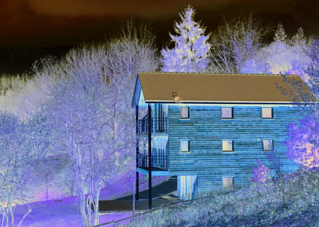

We've got a job to do where the client wants both PV and Thermal so we're looking either for a combined panel or matching ones
I know that Viridian do a matching pair, anyone had experience of either matching units or combined units and if so what is the performance and performance / cost ratio like?
Re Combined units the cost / performance ratio is important as the reduced output of either or both may mean the the Viridian (or others - hints please) matched approach may offer a better return for the £ invested. (reduce PV by a couple of panels and add in a couple of Thermal panels..)

Thanks all, we've got a roof space available of 13.3 m x 4.2m points just East of South, so pretty large area. The Newform Energy and Fototherm ones look interesting. - Newform's website though: No Downloads, No 'phone number, no company details, no address - it's all grand design stuff with no substance....

That is a good sized roof. Room for a lot more than 4kWp. The Fototherm is based on a standard 250W Mono Bosch panel and are 50mm deep ( Newform are 100mm I believe). Would they want or are they able to exceed 4kWp?
What is the hot water demand? What type of heating does the building have? Is there room for a thermal store? (300 litre min).

Heating will be underfloor and GSHP and a thermal store (all being redone at the moment here's a photo of the property (don't you just love my typical clients :) ) (thats 8 m to eaves, and artificial slate on a warm roof :) )
