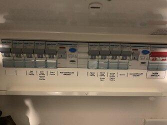

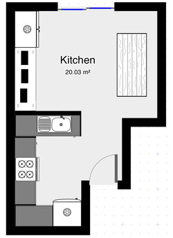

I have attached a picture of the consumer unit and also the floor plan to help clarify what the aim is.
The aim at the moment is for my partner to set up something small scale on the side, hence why we are looking to run it from home to begin with. The ultimate goal (post-covid) is to expand and look at a permanent commercial premises which will remove these limitation.
As you'll seen in the floor plan though, the current kitchen is fairly small and consist of electric oven, gas hobs, fridge/freezer, dishwasher and washing machine.
On the other side of the half wall we have a double fridge/freezer and a table top with the below equipment:
Fryers - (Voltage: 230V, 50Hz) (Power: 4 x 2800W) (Current: 4 x 12.2A)
Griddle - (Voltage: 230V, 50Hz) (Power: 2200W) (Current: 9.6A)
As you'll also see- there's not really a lot of room for expansion/additional equipment so if I could accommodate for the above with a little additional capacity for some breathing room that would be more than sufficient.
I was thinking that it would hopefully be a job I could get an electrician in for but wouldn't be that large of a job for planning permission. We'll also be looking to get a fire risk assessment and make sure everything is in order.
If the costs are going to be in the £1-2k range that would be reasonable but then if the only way was a three-phase supply running into the several thousands plus then that won't be an option for me.

I think what you are planning is feasible, I would ask a couple of local electricians to quote, there may well be some on here that are happy to quote if you ask.
My suggestion would be a single cable from your existing board, run to a new board in the room you intend to kit out.
from there, surface mount in conduit to all the new sockets, again surface mounted sockets.
1 to 2 days work, 300 to 600 for materials would be my guess.
when you eventually need to turn it back into a domestic room, it is as simple as removing the single cable that feeds the new board and removing all the surface mounted stuff. bit of pollyfilla in the holes and you are good to paint it.

Would this single cable come from the spare 32A breaker on my existing board as this wouldn't be enough? I like to understand what's happening and having done a little bit of looking I've seen that henley blocks are used to install sub-consumer units?
I like the idea to surface mount though so I can easily put it back to normal in the future.
