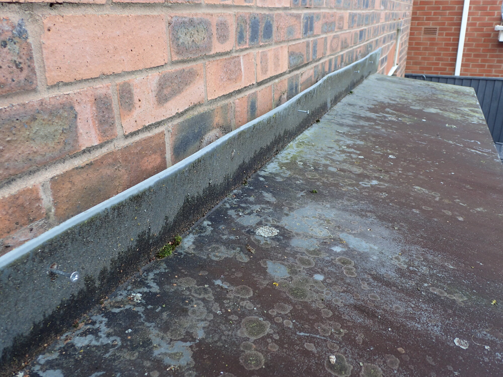

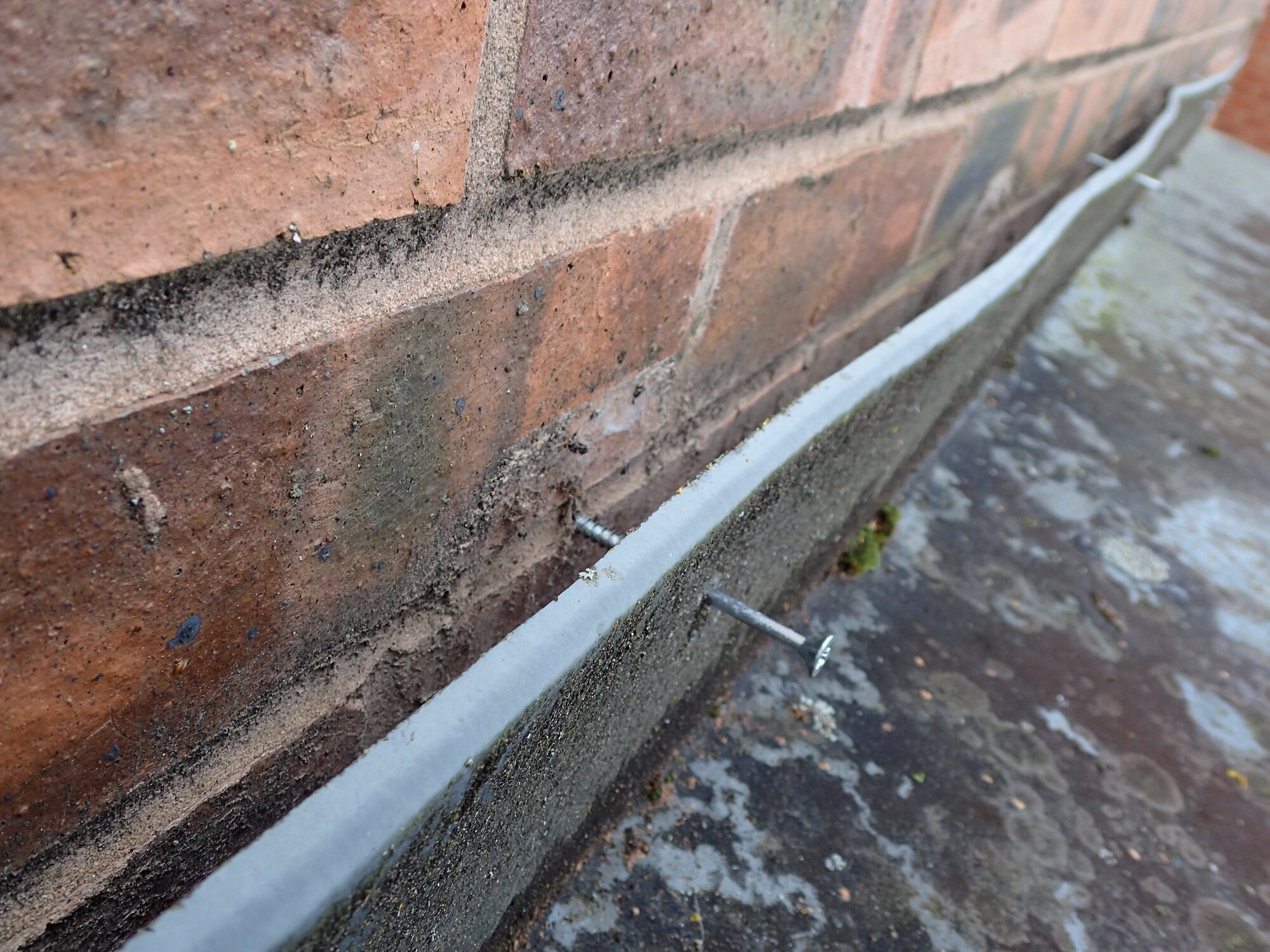

Basically, there was no removable lid to the canopy: the canopy was one piece of hollow fibreglass, with an open back and 3 internal vertical supports of fibreglass-clad OSB to give strength and rigidity. It was fixed to the wall by screws through the flashing upstand, and a couple of ornate scroll-y bits supporting from below.
One by one I removed the screws and replaced with longer ones, only partially screwed into the wall. This allowed me to gently pull the canopy clear of the wall by an inch or so, and have a look in the back with the endoscope.
